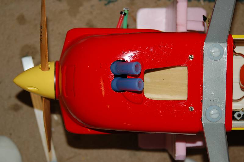

Cooling isn't a simple deal for most folks.
You really need to have an intake area the size of the front of the engine, and you need to place that area in front of the engine as well. Then you need to have the exhaust opening behind that engine. If not directly behind, then as close as possible. You want the air coming in to be directed and routed close to the engine when possible.
Control line proved years ago that the heat exhaust opening can be as small as 1.4X the intake opening and work great. But that's with the "pressure cowl" rules just listed.
It also helps to have the heat exhaust opening in an area of negative pressure. Lot's of times, if the exhaust area sees enough negative pressure, the intake really works great.
Also, what you don't do is as important as what you do. Don't have openings that let cool air in where there is nothing to cool. If you do that, the cool air will basically trap the hot air around the engine and the hot air stagnates, doing more damage than it would otherwise. Openings that aren't in front of what needs to be cooled can screw up the picture.
Cool air is easier to move than hot air. So cool air coming into the cowl will move around the hot air that needs to be pushed out, and winds up pushing out whatever cool air it finds. And that flow of cool air basically can take over the exhaust opening.

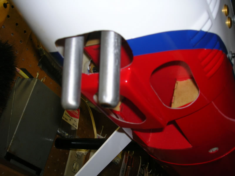

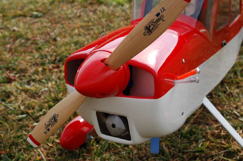

You know, the best plan for a good cooling setup starts with the exhaust and moves forward. My two pictured models could easily be setup with 1.5x exhaust area considering the opening in front of the engines, but that was about it unless some massive hacking was done to get more exhaust area. So both models needed less intake to have a good intake/exhaust balance. With the Decathlon, the intake area in front of the muffler actually had better flow to the exhaust than the engine intake. So that one really didn't want or need that offside opening that wasn't in front of the engine or the muffler. That opening was definitely not wanted if any hope of having at least 1:1 was the goal, and 1:1.4 is the minimum goal.
I'm flying today and the prediction is for temperatures in the 100s. It's funny, but the guys talk about my models having "closed openings" and they always wonder how my engines run cooler than theirs. A couple of them have cooked engines. They usually blame the last needle setting.
It's actually a simple design layout. At least 1.4X size exhaust to intake. That means making a decent exhaust AND closing off or baffling intakes that are "surplus" and in the wrong place.

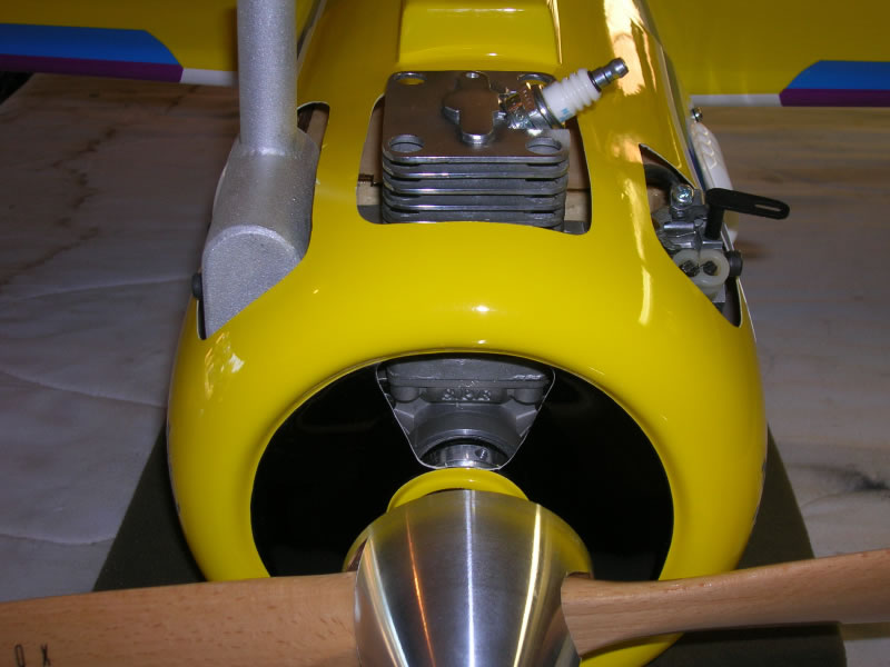

If you look at the 3 pictures I attached to post #7, the 1st and 3rd pictures show baffles in place. Those two cowls have openings both sides of the spinner. The engines happen to be behind one of the two holes. The openings are more than adequate by more than twice. That is to say, the opening in front of the engine is absolutely adequate, more than adequate to allow enough air in to cool the engine. And darned if there isn't another hole equally as large on the other side doing nothing except allowing a huge amount of cool air into that cowl.
Now think about the suggested sizes for exhaust openings. If you go with 3:1 as many people suggest, you'll wind up having no cowling left behind the engine. If you look at the middle picture, you'll see a opening that is about 1.5 times as large as ONE intake opening on that airplane. And it's pretty big isn't it.
The baffles in pictures 1 and 3 could have been made of scrap wood, or cardboard, or balsa or anything. I used scrap expanded bead insulation sheet. I use it for lots of things because it's almost zero weight and glues nicely with epoxy or canopy glue. And it sands great. I fit it to things by sticking a scrap of sandpaper into where I want it to go and rub the foam around like I was snugging it into place. The sandpaper fits it perfectly and it takes about a minute to do. You can buy the stuff at Lowes or Home Depot or any home improvement. I also make building stands out of it. It's fuel proof.
In both the Cap 232 and the Decathlon, those baffles basically are about as big as what you see through the opening in the cowl. They angle back slightly to divert all the air that can make it through the opening on that side of the cowl directly at the bottom of the engine. They'd work just fine if they actually plugged that hole tight.
When you leave those offside holes open with nothing behind them, the air that comes in there blows right to wherever the exhaust opening is. The warm air from the engine really gets blocked in the cowling. Cool air is easier than warm to move. And warm air really has trouble moving cool air. Cool air has no trouble moving cool air. So the cool coming in has no trouble filling whatever vent area you made available because cool air is going out that hole.
Baffle or block the offside holes. Your engine will be happier for it.
I used the fake engine of the F4U Corsair to block about 3/4 the opening in that cowl. There is a large hole in the fake engine right in front of the OS91FX, and two small holes at the very bottom of the fake. They're right in front of the pitts muffler. It's good to have air hit it too.
