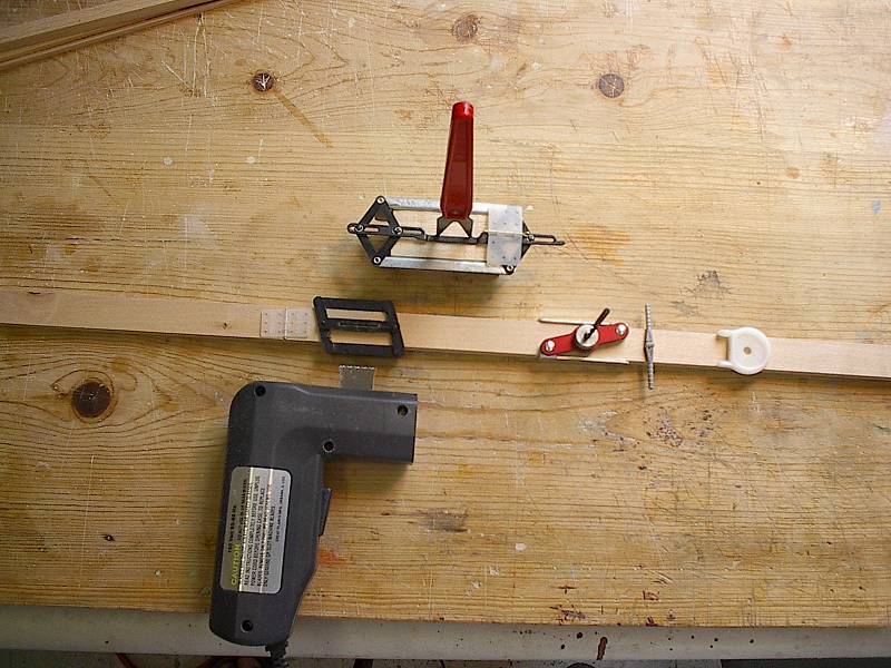

I have never had great luck with anything that has the Great Planes name on it and that includes my hinge slot machine, both sides are supposed to cut, mine only operates one side?? Yes, I have checked it out and replaced the blades.
I have used other peoples machines and they work quite well, GP just hates me for some reason.

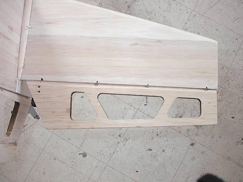

I use different sizes and types of hinges for different planes and reasons. I posted photos yesterday of 3 types of slot cutting guides that will help keep the hinges centered, these work very well.
Hinge pins are the easiest to use but not always the best, if the plane isn't set up to use them they can be A problem and weaken the LE & TE and may not have enough wood to be glued in very well.
I don't use CA hinges anymore but there really isn't anything wrong with them. Like anything, if someone shows you how to do something it's much easier, CA hinges are easy to install and work very well, I think Mike or Ken have an instruction thread on how to install them?

Are those Robart 1/2a's in your photo? Have you had good luck with them holding up?
