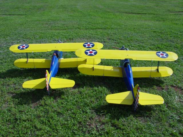

My friend and I have these Hog Bipes with OS .70 4 strokes in them and they fly just perfect.

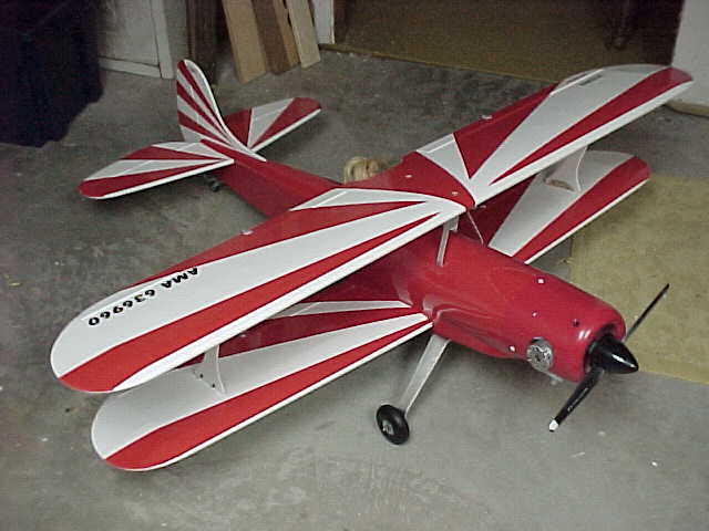

I have built and flown a couple of these great bipes. Both have had a .61 Magnum 2 cycle and fly great. I have seen many with .92 4 cycles on them and even one with a 1.20!
Here is my latest one, round cowl, re-shaped tail feathers, and a rounded fuse.
You only have too much engine when the landing gear is too short to let the prop clear the ground! :stupid:
