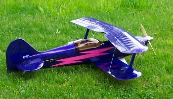

Old 05-28-2003 | 04:35 PM
iflircaircraft's Avatar
Posts: 762
From: Grovetown, GA
Default US40+ vs US40
Thanks Minnflyer:
BTW: The skybolt is ready to fly, just waiting on the weather.
here's a pic:
Tom
