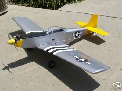

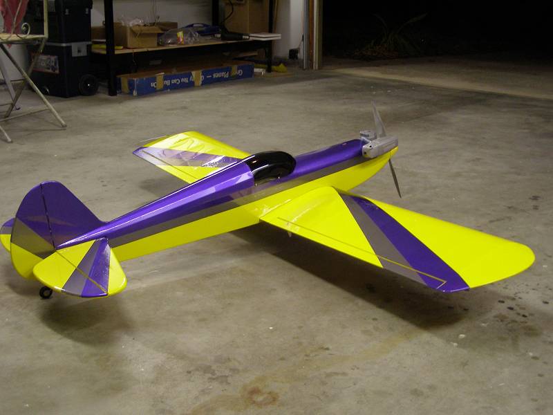

Here are some of the Monokote covering jobs I've done over the past few years and ARF's with nice Monokote covering...
Monokote works just fine in my opinion. I also have covered planes in Ultracoate with great success. Neither is worse than I other I don't think, just a little different.

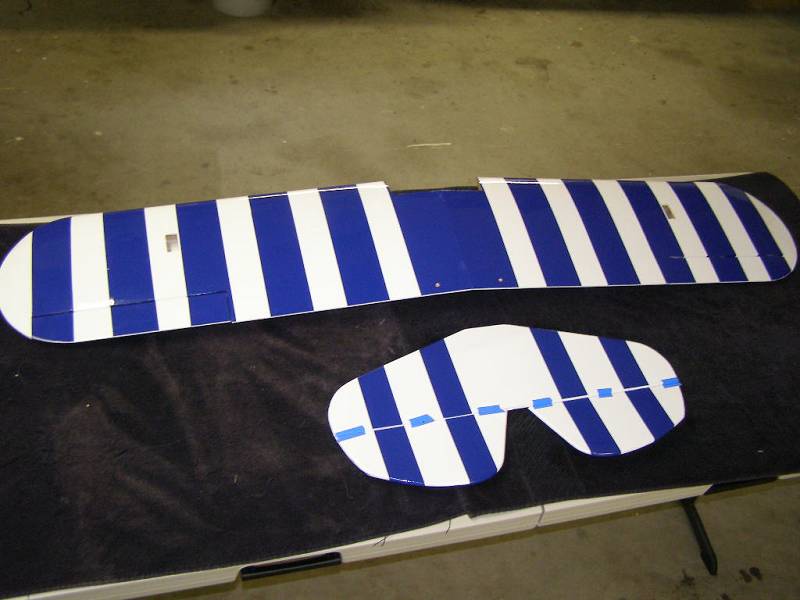

Here's the progress so far with Monokote on the biplane. I know it isn't a traditional Christen Eagle scheme but the thought of cutting all those multi-colored feathers doesn't sound like fun.
There isn't a wrinkle or sag anywhere on it so far. What I do is pull, tack, pull tack, pull, tack and so on to get the covering fairly snug. I don't pull too hard but just enough. Then I take an iron hot enough to activate the adhesive but not shrink the film and stick the edges down. Next I use a heat gun to tighten everything up. finally I take the iron again and stick everything down to the wood and touch it up with the heat gun if needed. Works great for me.
