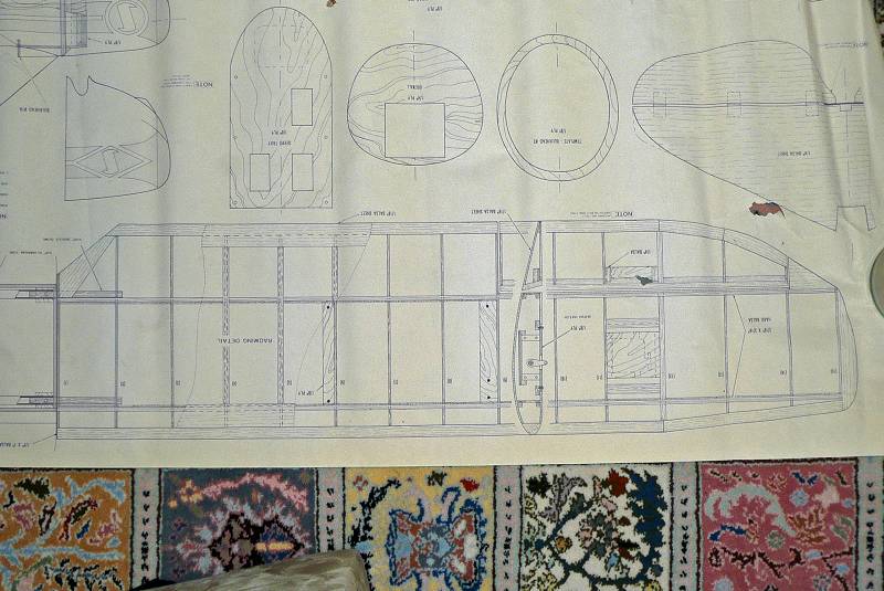

I have a JMD Models kit (now out of production) that has glass fuse and of course ailerons. I believe it is about 72" span. The plane is unbuilt at this point. The plane can be built with fully sheeted wings (simulates metal covered wings, which some planes have) or just built-up (simulates original standard fabric covered wings.)
I have had a Saito 60T twin that I bought just for this plane. This engine is as smooth as an electric motor.
If you want, I could post pictures of the plans to allow you to construct the ailerons in a scale manner. I believe the plane is very much to scale, as the owner of JMD Models owns a full scale Silvaire from which he drew the plans.

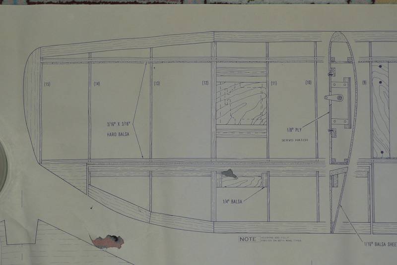

Thanks for the pics. Good info to have. I had started on one wing half and the info confirmed what i was doing. Thanks again for your time. Would love to see some pics of your luscoumbe.

Attached please find the photos of the ailerons on the JMD Models kit.
This plane has a little larger span than I remembered: it is 78".
To orient you, one pic shows the ail closeup, the other a 1/2 wing panel.
The length of the one wing panel is 35 1/2". The span of the aileron is 13". The chord of the wing is 9 3/8". The chord of the aileron at its widest point is 3 1/8". The relatively short aileron then has a chord of exactly 1/3 that of the wing. This is relatively large, but the ailerons are pretty short on the Silvaire.
Hope this helps.

Here are the pics.
