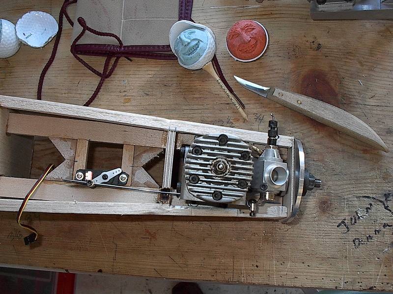

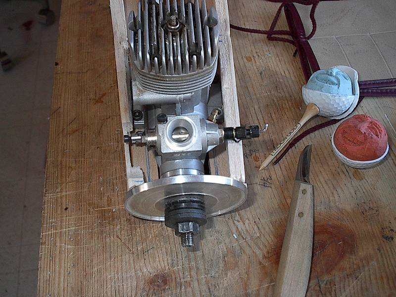

Old 03-15-2009 | 08:05 PM
My Feedback: (-1)
Joined: Apr 2003
Posts: 14,400
Received 9 Likes on 8 Posts
From: Hemderson, NV
Default RE: Engine mounting tips
Just messing with you, this is real old school beam mounting.
