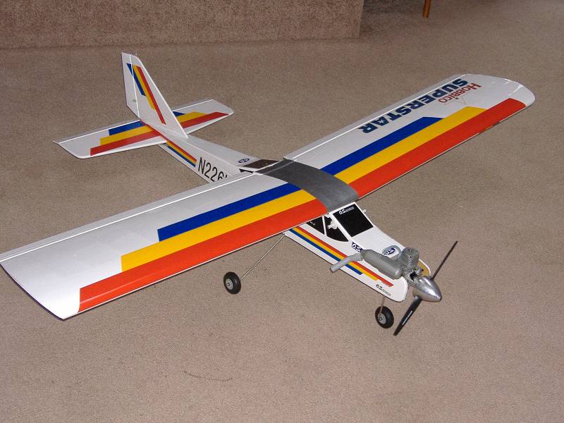

This is my other trainer, its a .40 sized superstar upgraded with flaperons. [>:]

In my opinion the wing is bigger than 2 mts. and the fuse is sooo fat, then I would bolt the engine that you already have in your trainer and see what happens, I bet that you are planning to bolt some kind of landing gear. The plane will float fine but it could be very hard to get some altitude with that fuse.
