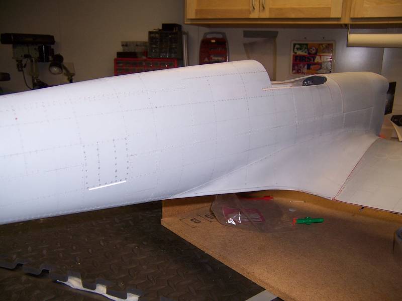

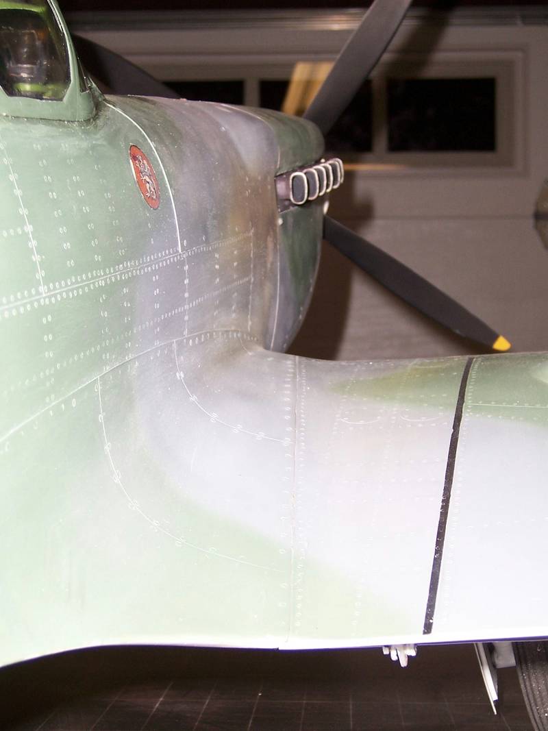

ORIGINAL: ro347
MMmmmm...jusr curious. what are you guys using this for exactly?
I use high build primer to fill the weave, and to fill in any low spots on the airframe. Most of this primer is sanded off, ending up on the shop floor.

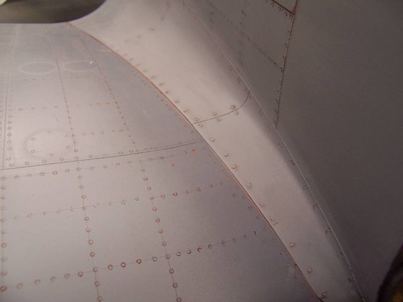

I use Duplicolor High Build sandable primer for filling the weave on glass, and for adding panel lines and rivets.

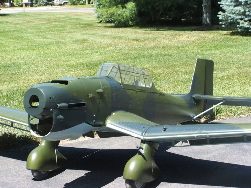

If you don't want to go that route, the SEM High build primer pictured above is a fairly good substitute. Doesn't have the filling abilities of the MarHyde or the Durafill, but in a pinch or for small projects, it'll do.
