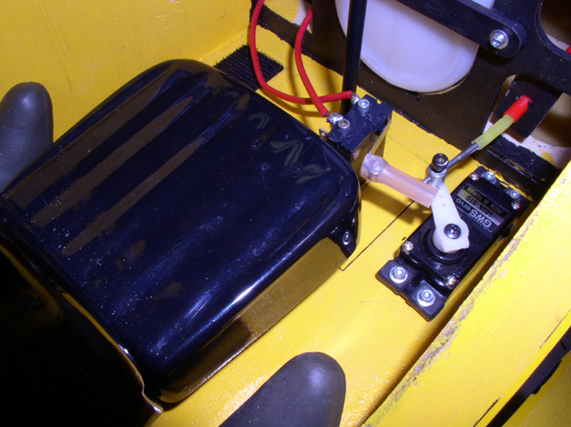

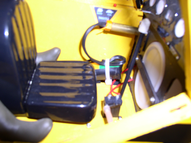

At this link you'll find the drawing of the system for on board glow, by the way, this is a great site to find a lot about model airplanes. http://www.geistware.com/rcmodeling/...low_system.htm
Below are the pics of my setup using a micro switch from Hobby Shak, I'm using a piece of silicone fuel line to elongate the on-off switch as I didn't have enough space to have the throttle servo pushrod activate it, due to pilot seat being in the way. I have a glow plug connection on the dash board (connecting to the glow plug on the engine) so it is very easy to plug and unplug the battery with a simple twist in order to charge it or using it to start other engines directly on the glow plug, the battery is being held on the floor of the cockpit with velcro, works like a charm!
On another airplane I have exactly the same setup as the one on the schematic (link) with an alkaline C battery, lasts for a whole weekend, then toss it away, on this one, I have the wire that connects to the glow plug attach with a small wheel collar soldered to the end, works perfectly, never comes loose. Hope this helps.

Lnewqban's Avatar
Joined: Apr 2007
Posts: 4,057
From: South Florida
Default RE: Glow drivers?
Great pictures, thanks!
The silicone tube is a very clever solution, which simplifies the adjustment a lot.
Do you do anything to de-energize the plug whenever the engine is off?
Old 06-09-2009 | 09:31 AM
My Feedback: (16)
Posts: 719
From: palm harbor, FL
Simple, after you kill the engine, move the throttle stick anywhere from half to full throttle, before turning the radio off, this will release the pressure the silicon tube is putting on the microswitch, thereby ending the contact. (The juice comes on at about 1/4 throttle). If you forget to do this after every flight (which I have) you culd ran out of battery power. I've left it for days actually and the plug didn't burn out, the battery I use is 1.5 V 3600 mah, you don't have to charge it but once a month at the most, even if that.
