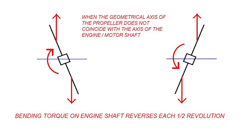

There are three forms of misalignment:
1) Radial and parallel to the shaft axis
2) Frontal and non- parallel to the shaft axis
3) Both combined
The manufacturer is stating and guaranteeing that:
1) The aft hole is concentric with the rotating axis of the body of the propeller
2) The aft surface of the hub is parallel with the rotating plane of the propeller.
3) If you don’t mess with those surfaces, the propeller will spin concentrically and within one unique plane.
4) The above has nothing to do with balance of the mass of the propeller (that is fine work left to you).
Just like unbalance, geometric misalignments will cause vibrations.
The manufacturer is asking the consumer not to modify the mentioned surfaces, if the hole diameter needs to be modified, since he knows that a manual work will lead to misalignment.
This introduced misalignment will be compensated by the adjustment of the mentioned surfaces against the shaft and the back plate.
MinnFlyer schematics posted above explain this perfectly.

This may be happening to your assembly of propeller-engine, which is common for holes that are modified by hand and get misaligned.
