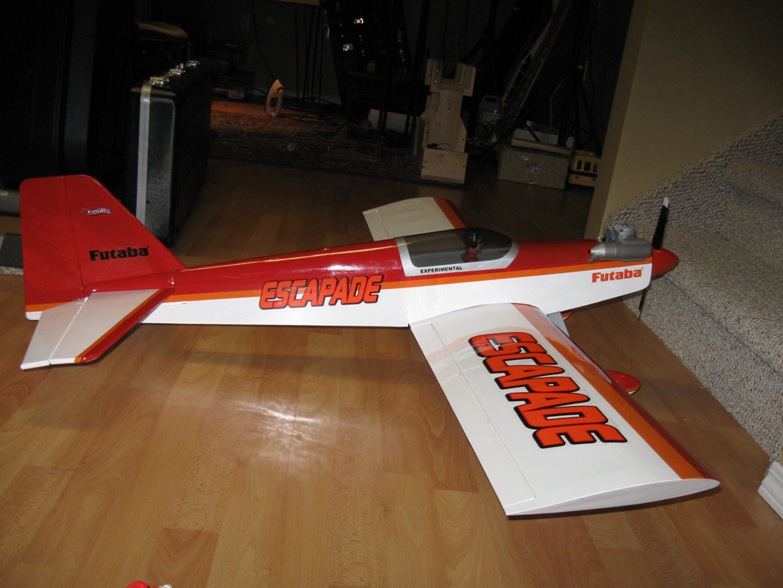

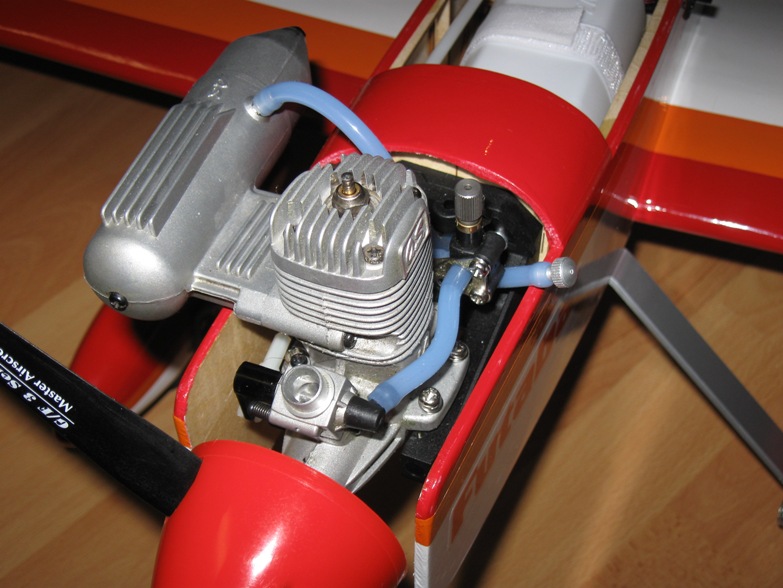

Well, here it is, I bought an Escapade and transferred all my trainer gear into it. The build was fairly easy, although I was suprised how poor the covering was on it. It took me nearly 2 hours of ironing to get it tight and wrinkle free. However, it's a beauty and my gear fits it perfectly. So far I have just the one aileron servo but I may "upgrade" soon enough (Futaba S3003's are dirt cheap).
What would be the best choice of prop? I have always used 10x6 with the OS .40LA for my trainer, although I found for some reason the wooden one's didn't have as much power. Should I stay with that or go to 11x6 or 10x8?

Stick with the MAS 10 X 6

Be sure to check the CG. I have a Magnum 46 XLS in mine which is heavier than your engine and I had to move the battery up to the firewall over the fuel tank since it was tail heavy. I also needed 3/4 oz in the left wing tip to get proper lateral balance. When she flew she needed only 2 clicks of right trim. I have been flying it all summer and it is great.
