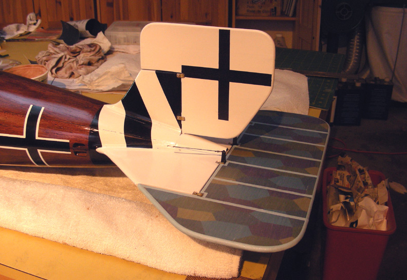

Here are some pics of the pull-pulls on my Siemens Schuckert DIII, first in CAD then the actual model.
All the servos are in the front of the fuselage for weight balance reasons. The elevator servo drives four lines (30 lb Kevlar - McMastersCarr)) through Goldenrod tubes (I didn't use the supplied braided wires for radio reasons). Small brass plates soldered to Dubro rigging connectors make up a "splitter" so each elevator servo arm can drive two cables. There is no Ackerman on this system and it works perfectly.
The fuselage on this model is balsa skinned and non-accessible but the plastic tubes allow the cables to be slid in from the ends very easily. All adjustments are at the servo end so the visible hookups are scale accurate.

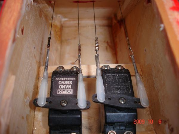

I've used a pull-pull setup once on an elevator system once, with great result. I did it primarily for scale detail, as it was a WWI plane (Bristol M-1). I used a single servo and bell-cranked it to a horizontal rod which had 2 arms, one for each pair of top and bottom wires. My elevator halves are tied together with a central rod, so if any one wire were to break, there is redundant control.
Like Rodney mentioned, I ran my wires through tubes to the exit points on the fuse. I used neutral Ackerman, and ensured all the tubes and pathways were symmetrical. this model was sort of a testbed for what I wanted to do on my later, larger scale WWI planes. The beauty of using the bellcrank and rod is that you can place the servo way up front if needed for balance, and run the rod back to the horizontal control, which allows you to shorten the runs of the control wires in the pull-pull setup. This can be for convenience of linkage location, and shorter wires are easier to maintain in adjustment for tension.
In the interior pics, you can see both the rudder pull-pull wires and the elevator pull-pull with the bellcrank arm to the servo, and the wires entering the tubes. I used coated leader line of about 25 pound test for my wires. This plane is 1/6 scale; I'll use at least 50 pound test for a 1/4 scale model.
