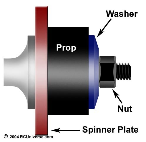

Most of the pics I post I just whip up in Photoshop.
The first 4 here are all Photoshop. The last two are done in Sketchup
I've been saving these almost since day one here at RCU and I now have a collection of over 600 images
