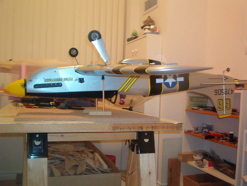

I only know of two methods to balance an RC airplane.
The first method is the finger method. This method is cheap but inaccurate. This is the only method I've ever used.
The second method is to buy the Top Flite contraption. Is this tool worth the money if I want to accurately measure the CG? I've also read a few articles about cheap home-built variations of this tool. My half-hearted attempt didn't work out well.
I've heard there is a trapeze method, but I don't know any details about it. Can anyone explain this method? I couldn't find anything about it when doing a search on RCU and Google.
Are there other methods to find the CG?

The Great Planes C.G. Machine does a very good job for me. I use it to balance all my warbirds, and all of them fly great.
Here is my WM Spit on the C.G. Machine:
Here is my Kyosho Corsair on the C.G. Machine:
This tool is a great investment.

In the June '03 Radio Control Modeler Magazine there is an article on how to build a very good balancing stand. I built one in about 20 minutes out of scrap wood I had hanging out in my garage and it works great. Just a suggestion.

definitely go with the great planes balancer or build on similar to it out of wood. The finger method leaves too much to chance, you will find yourself balancing the plane on your fingers instead of being objective.
Old 07-23-2003 | 05:59 AM
Posts: 822
From: BrisbaneQLD, AUSTRALIA
Default Balance methods?
I have a Multiplex stand which works well ! You will be surprised how much difference 1 mm makes. So if you have a hotliner which only has a cg range of about 5mm you could be way off using finger tips.
It is much easier (and more accurate) to adjust the the cg with the aircraft on a stand.

Been meaning to get back with you guys, I finally scanned in the article that I was talking about earlier on and put it up on my web page. Get it while you can, because I'm only going to leave it up for a couple of weeks so I don't get into too much trouble by the magazine.
http://home.comcast.net/~k.kimberlin...e/balance.html
Old 08-22-2003 | 04:24 PM
Posts: 973
From: Richmond Hill, ON, CANADA
Beardking...
Thanks for those pictures. It's looks like a much better and sturdier design than the one I devised.
Juice
