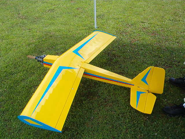

We have a lot of folks around here that really like a plane called a "Hooker" for windy day flying. It is more or less a Stick with a swept wing. The .90 size seem to be the favorite.
