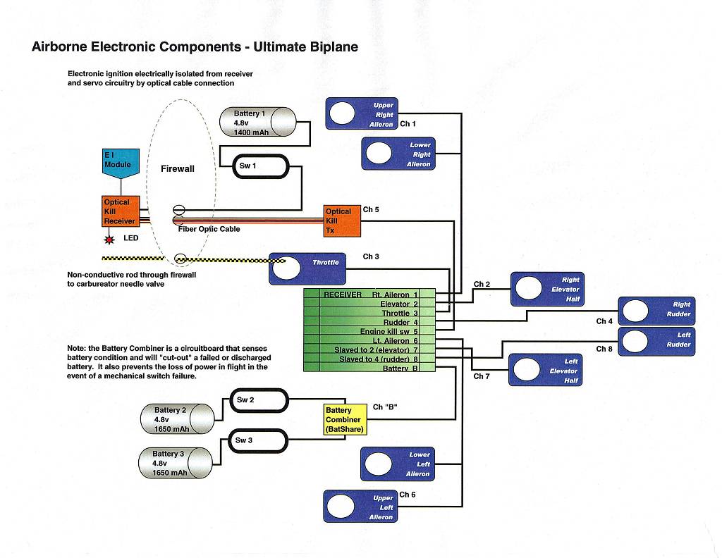

Sorry guys, could someone give me drawing. I do not want to make a mistake. My rec. is a AR7000 thanks

Can't draw anything for you but it isn't hard. You mount two on/off switches, you plug in a battery into each switch. You plug the two switch leads into any open RX ports. Same thing as only one battery set up but you are doing it twice. The RX doesn't know how many batteries are being plugged in.

www.smart-fly.com makes a battery combiner called the "Batt-Share". Two batteries plug in, it draws from the stronger until balanced and then continues. Should one fail it drops that circuit. It also plugs into two jacks or just one if you prefer) in the receiver for additional redundancy. Two switches and you're well covered. Here's a diagram of how my Ultimate is set up.

Do like summerwinds diagram. It doesn't have to be any more complicated than that. Or expensive.
