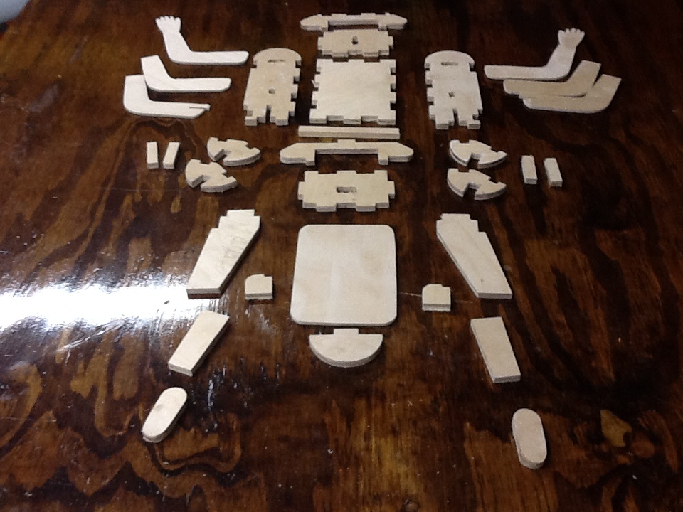

After a lot of work, I am going to build my first diver. I found the plans on line. I was very lucky and got a chute from TV Products out of Belgium. It is a very high quality chute. I have the little guy cut out and will post pics soon. He is a beginner diver. I am also looking for templets for a chute. I want to try to sew one, but that is a later project. Thats how is works one project on the table one in my head, lol.
ID:	1955969   Click image for larger version
ID:	1955970   Click image for larger version

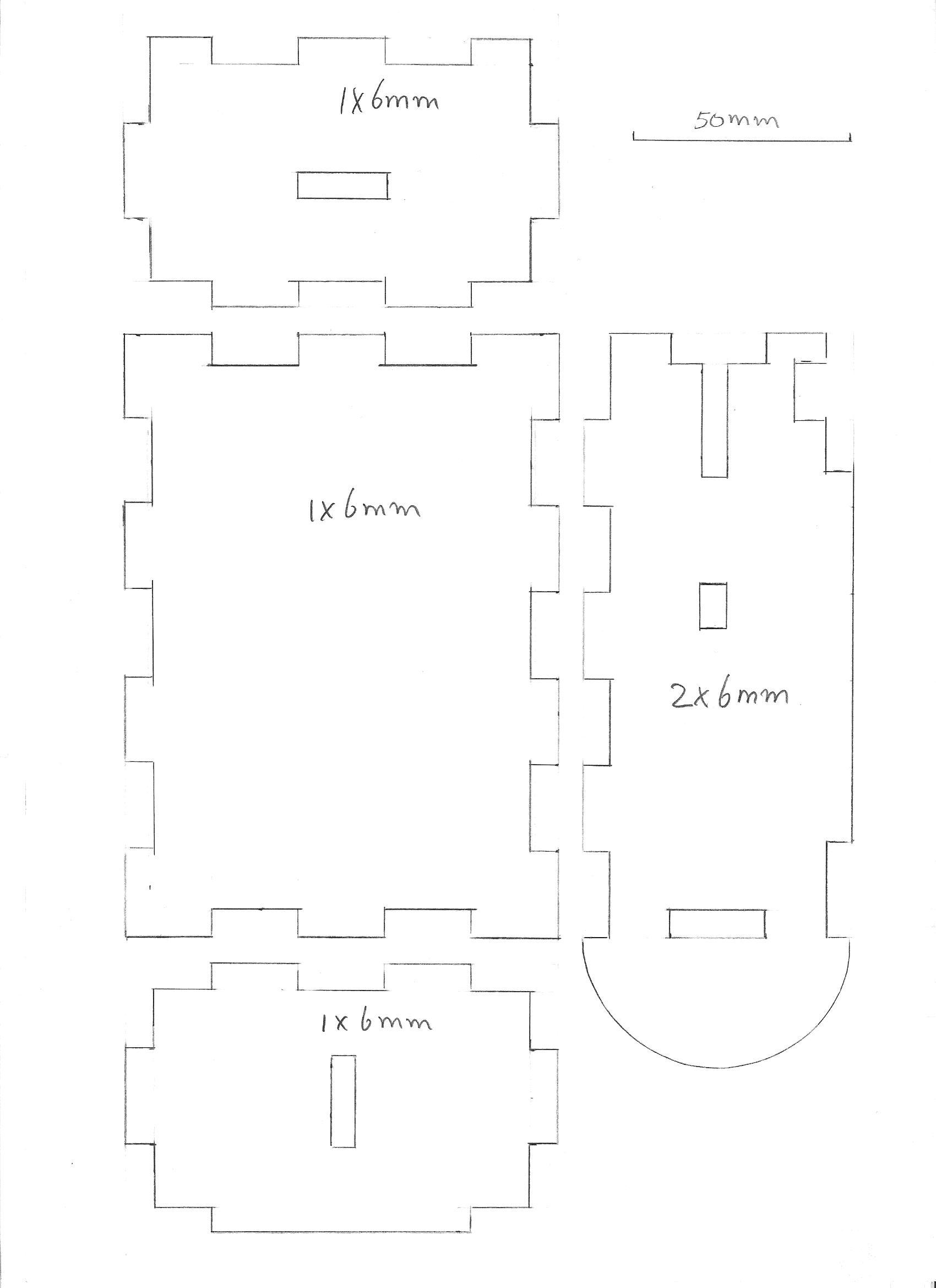

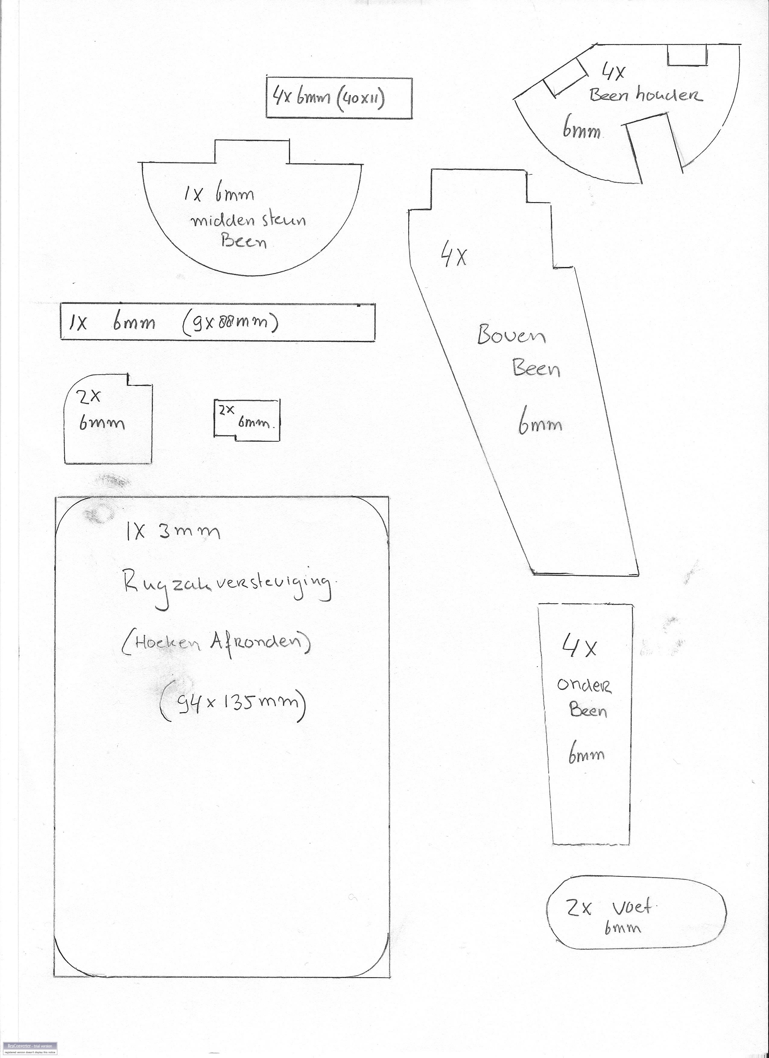

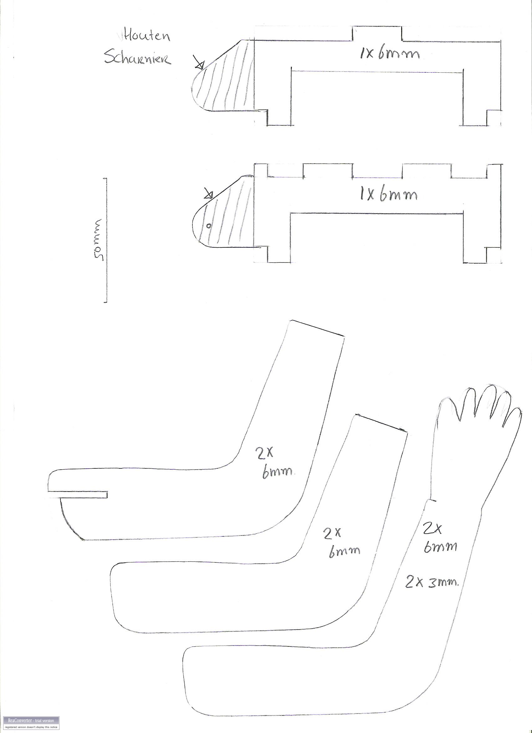

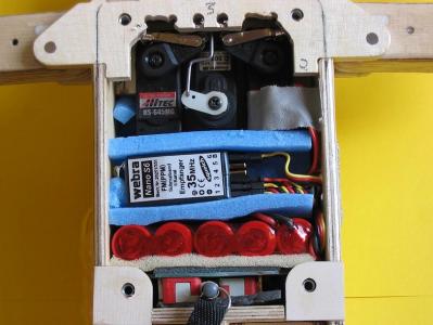

Hello Chris,
This little man is to see at the site Rc-parachute.nl and than looking for technics to the inside doll.
With this dolls do we jumping in the dutch competition.
Greetings.
Old 01-10-2014 | 02:06 PM
Looping0031's Avatar
Joined: Nov 2013
Posts: 44
From: Best, Netherlands

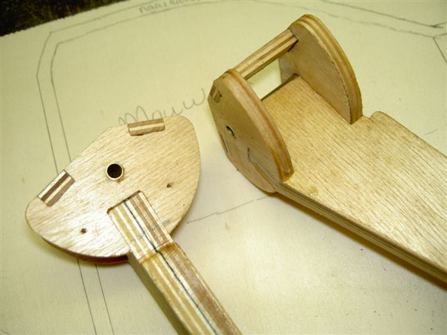

Here some pictures of the inside.
Greetings

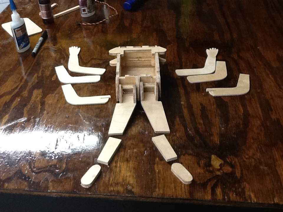

Default Got everything cut out
got everything cut out

Old 01-12-2014 | 05:54 AM
Joined: Nov 2013
Posts: 44
Nice work Chris. I'll follow this from here.

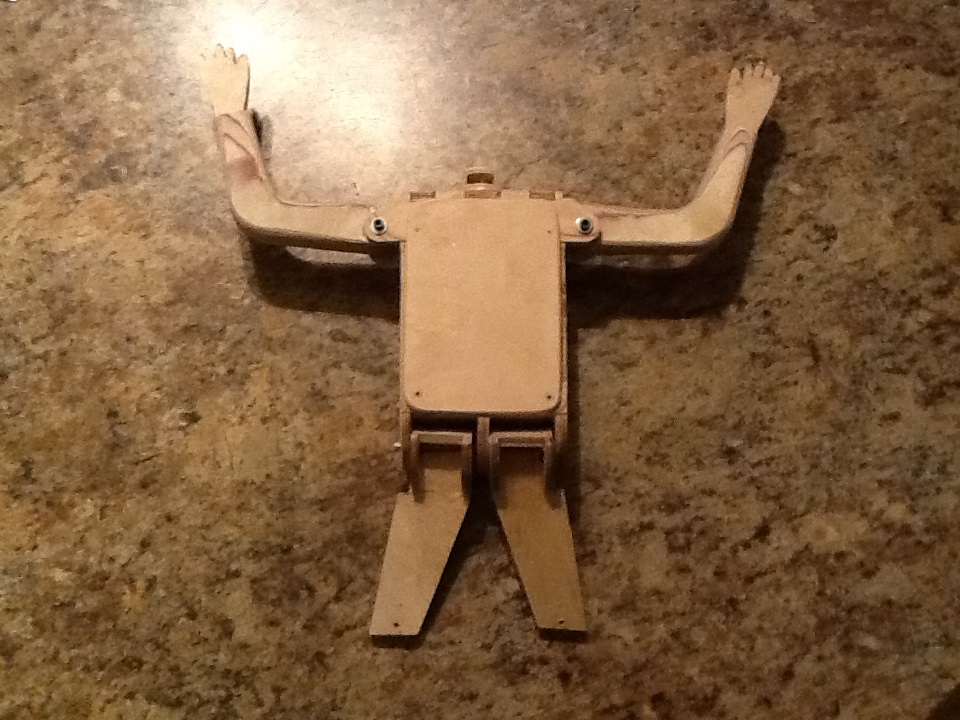

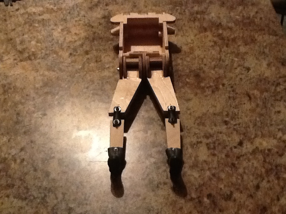

Got the legs on to day.

Old 01-13-2014 | 12:10 PM
Joined: Nov 2013
Posts: 44

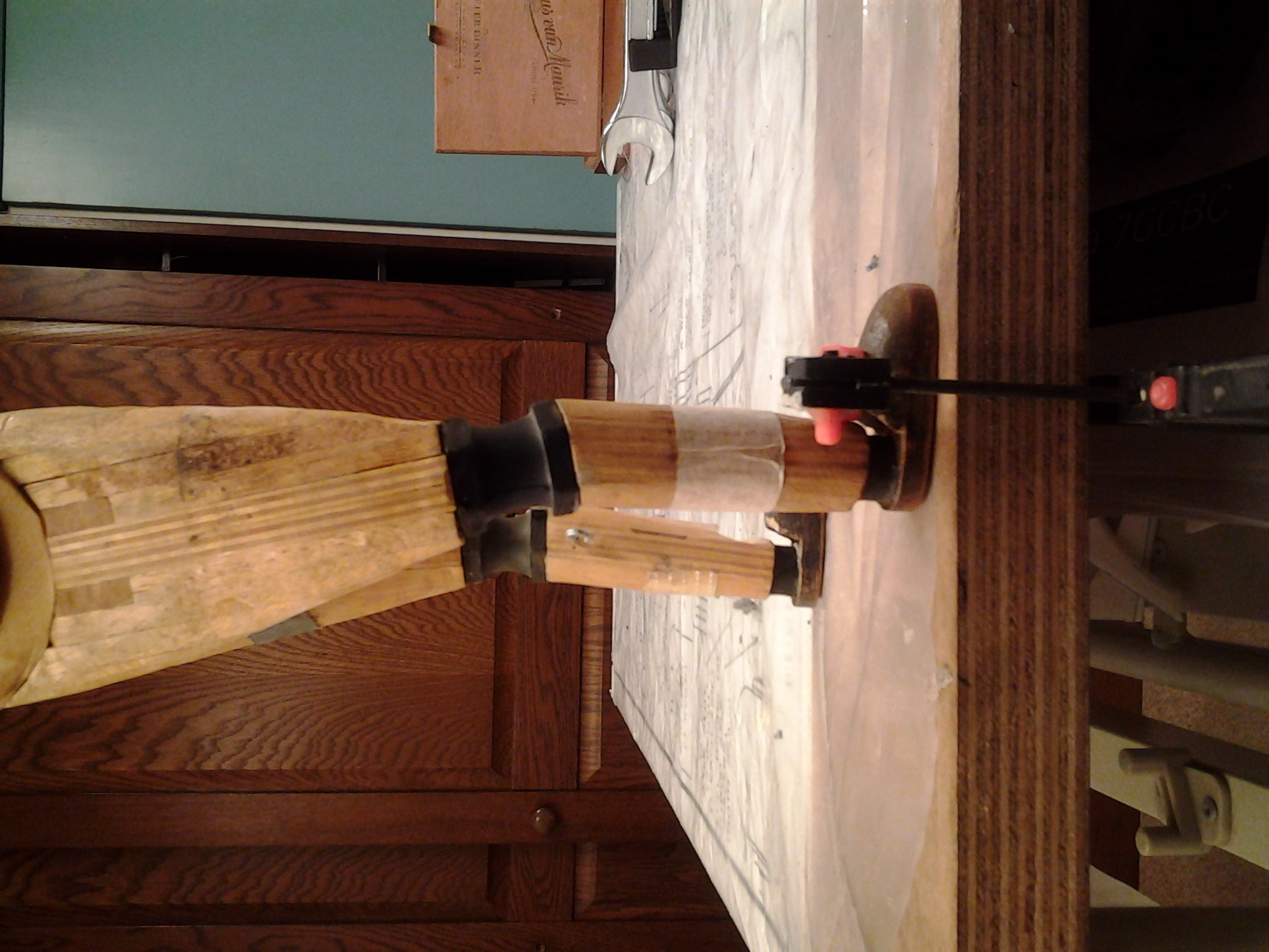

Hello Chris,

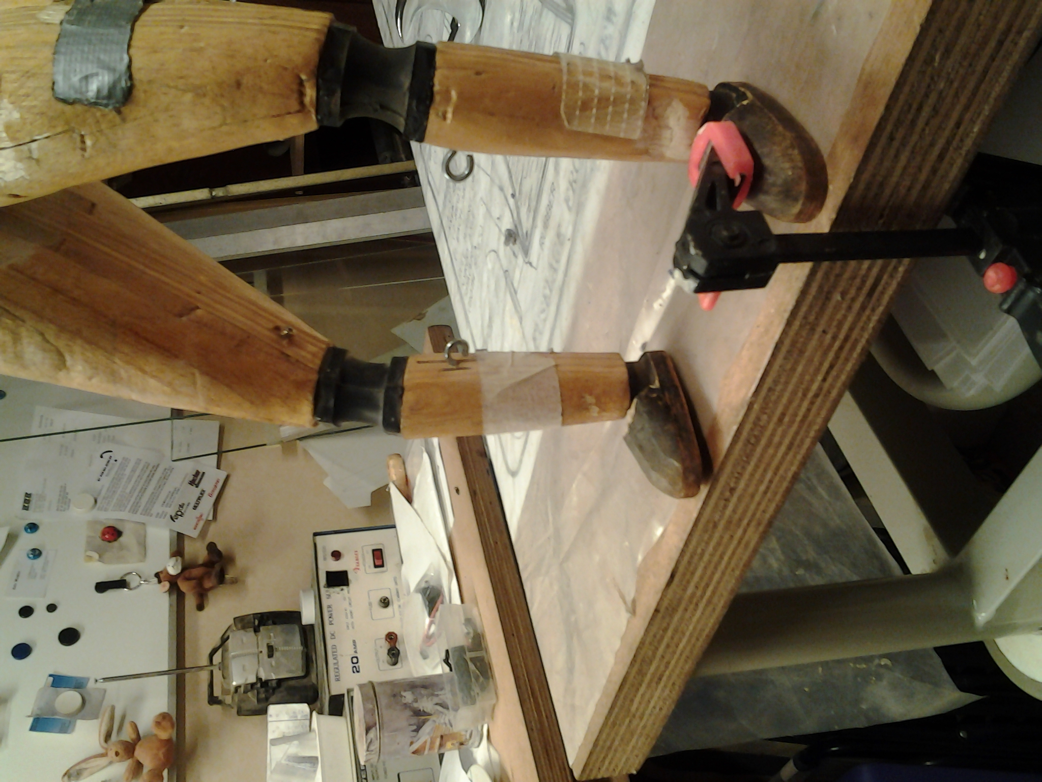

If you like you could the next time to make the knees and enkels like this, because they has to be strong and is good bending by the landing.
we have try another methode but it brake down after a few times.
Greetings

Where did you get the rubber for the knees?

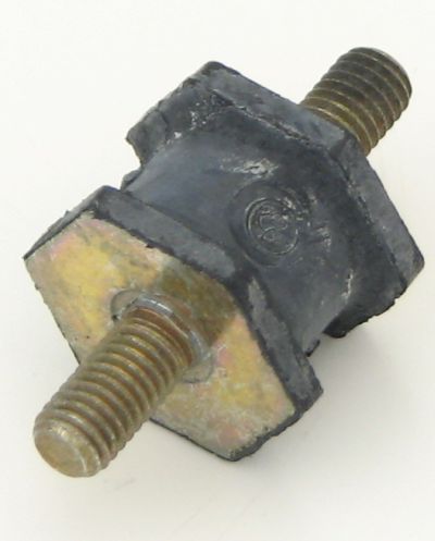

Old 01-13-2014 | 06:56 PM
GaryV's Avatar
Posts: 438
From: Stuarts Draft, VA
Chris ,
Do a search for anti vibration mounts.
Most hardware stores have a selection.
Name:	0019875240 anti vibration.jpg
ID:	1957493   Click image for larger version
Name:	mtM3doiNYKq67hD3Nw93Hyw mount.jpg
Old 01-13-2014 | 07:07 PM
8219chris's Avatar
Joined: Feb 2010
Posts: 33
From: mount croghan, SC
Sweet, thanks a lot

got the arms on today.

I found the anti vibration mounts at this web site http://jwwinco.com/products/section7/index.html They were $1.00 each. This is the cheapest I have found them. Most places they are 4-6 each. I will post more on the build when the parts come in.
