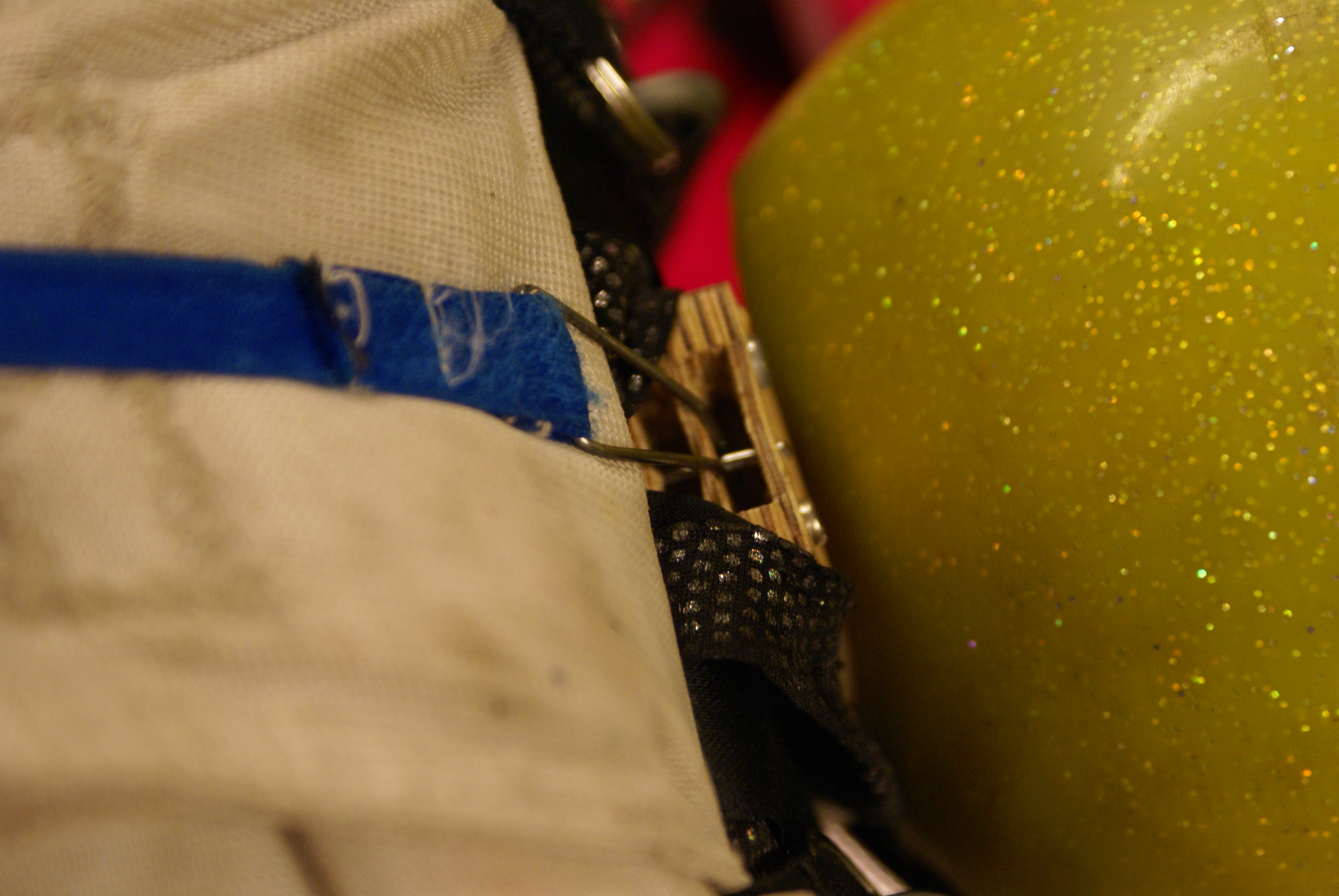

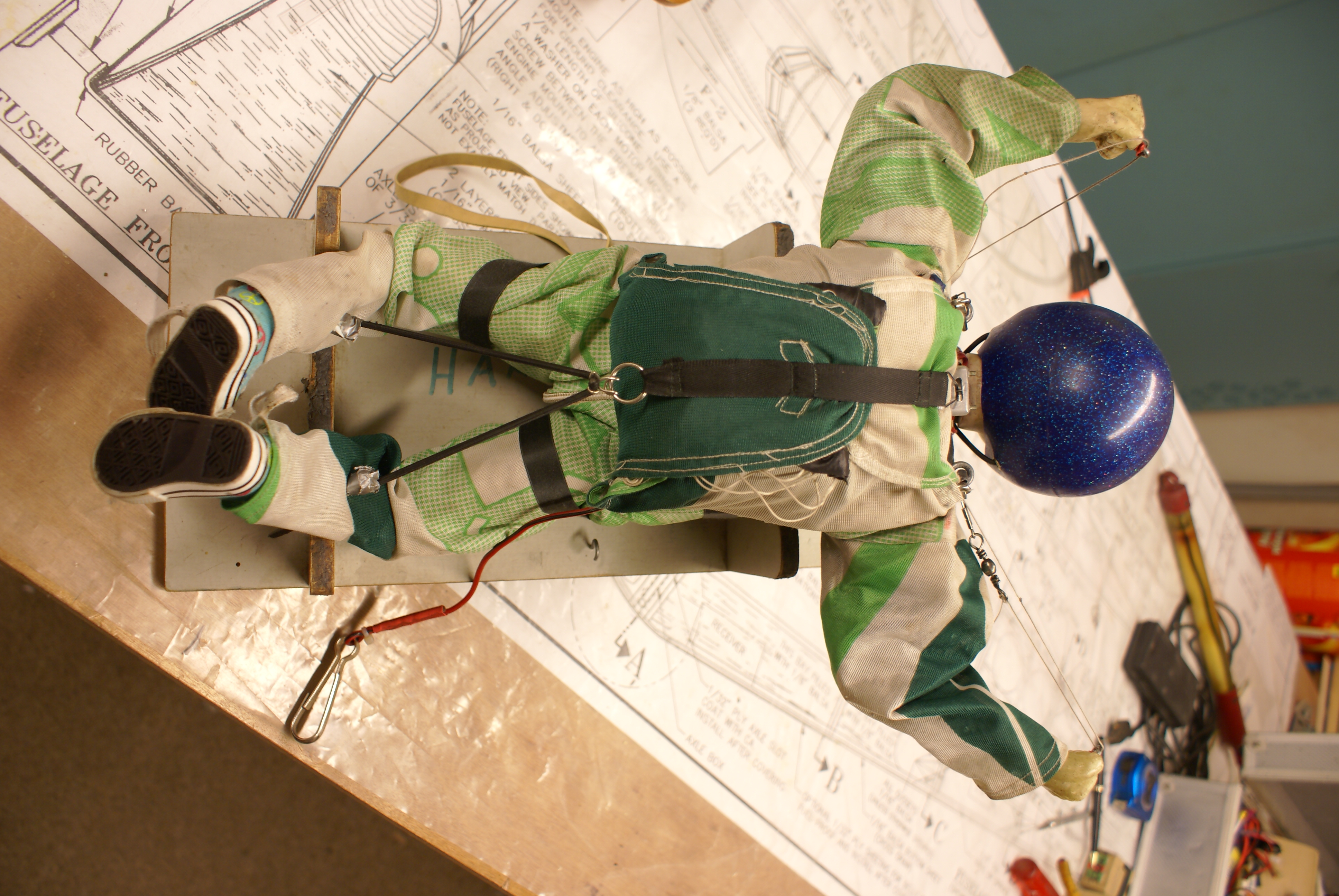

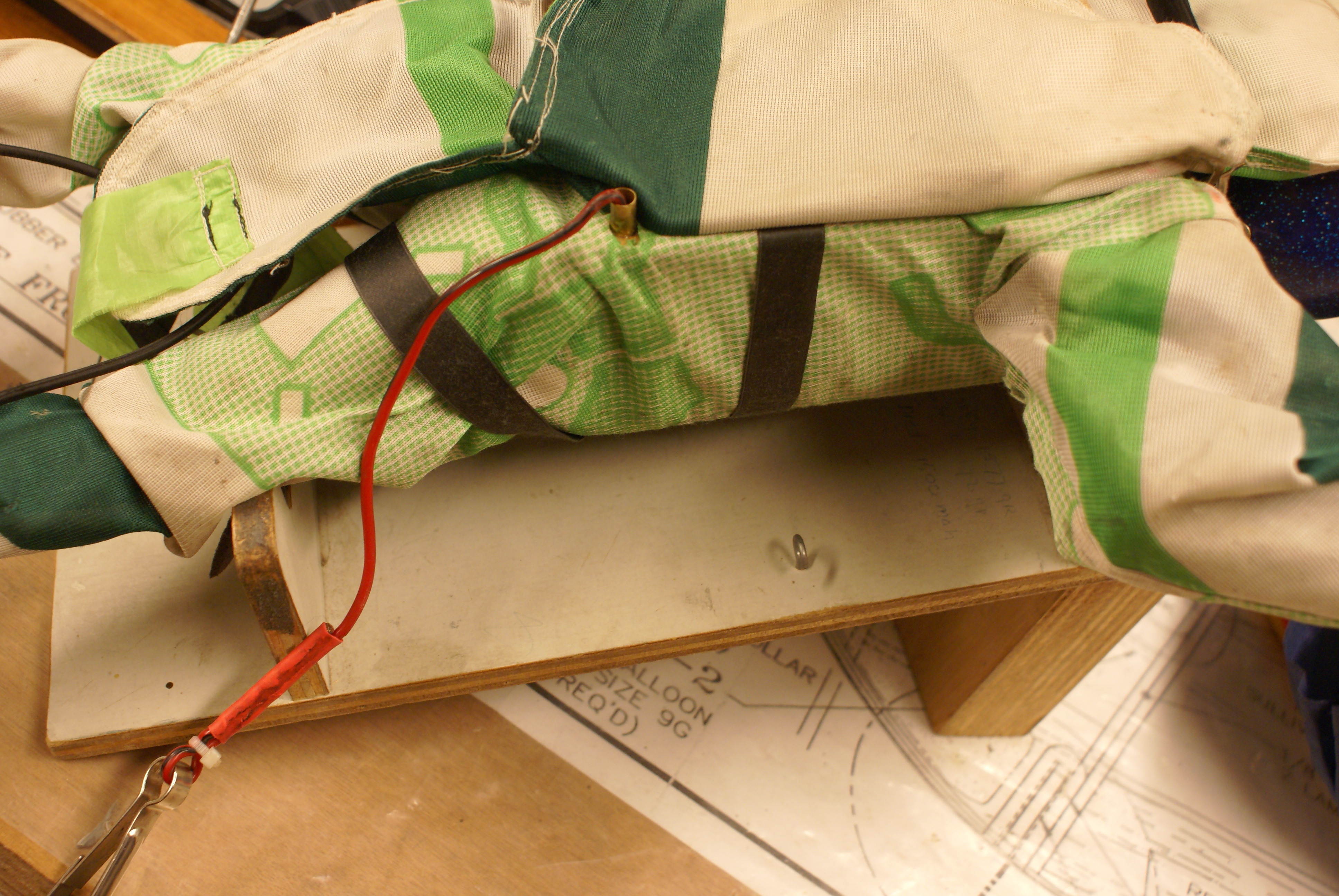

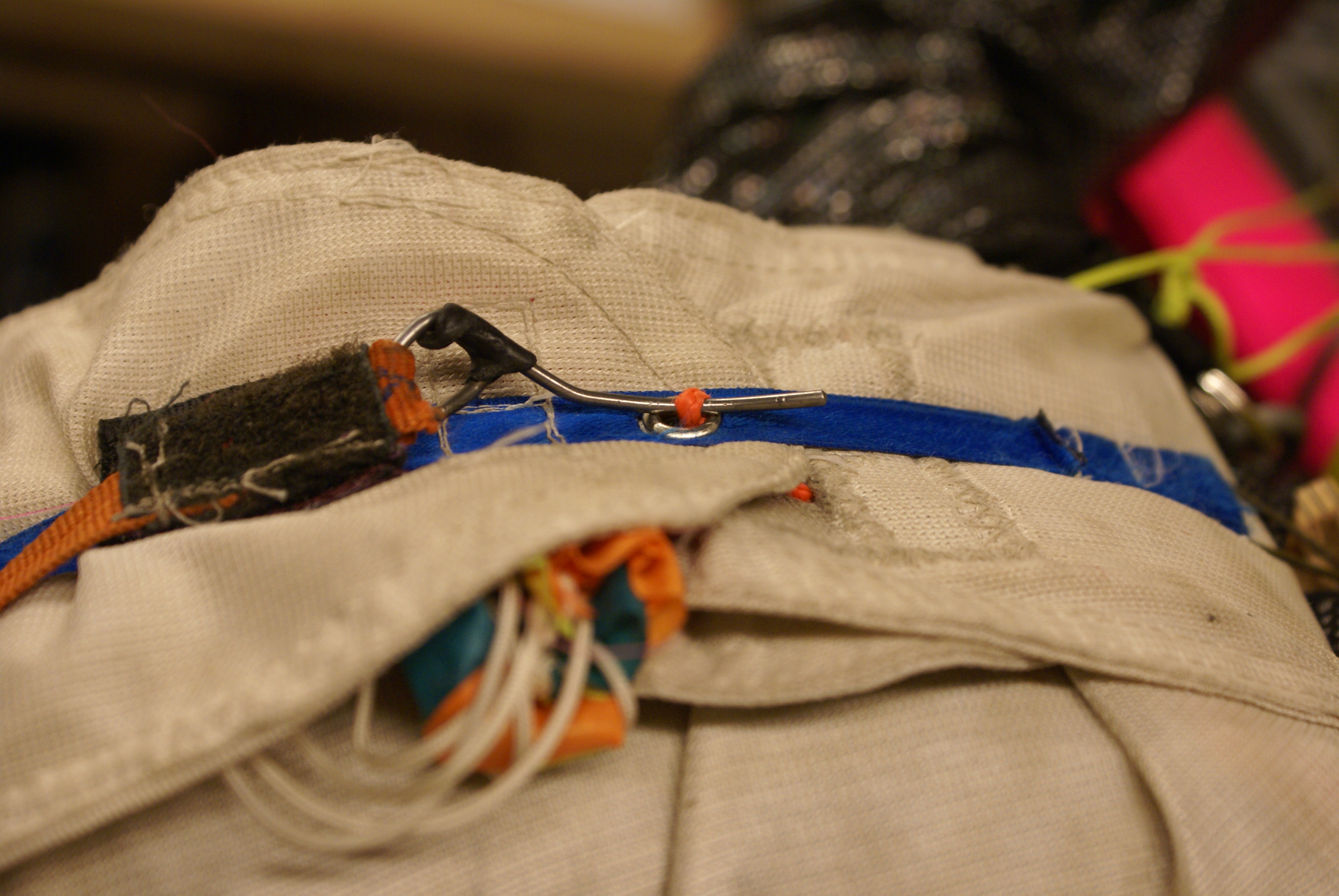

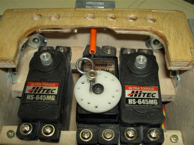

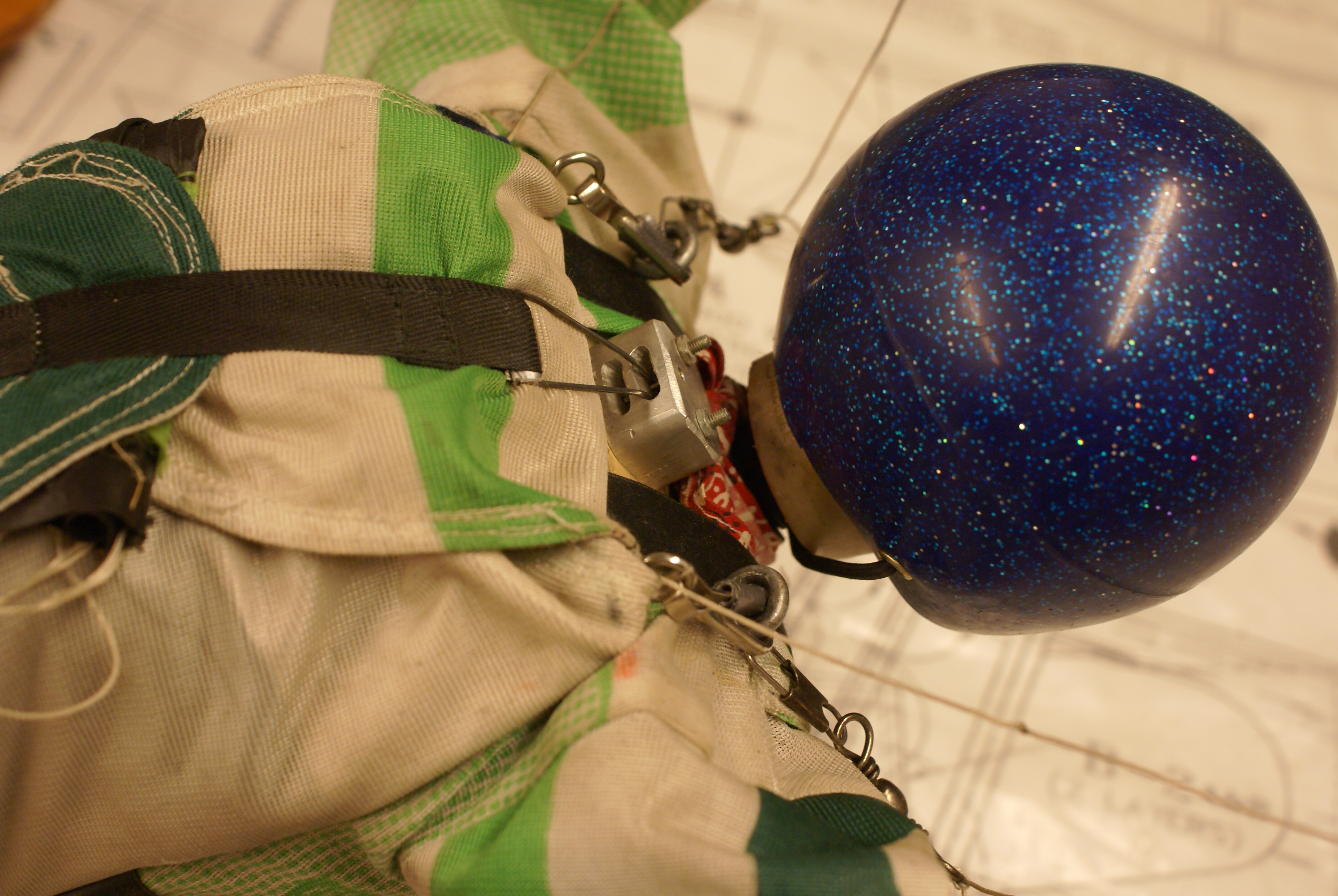

Hello,
There's a pin in the jumper neck, when you move a switch on your transmitter than will open the backpack.
Another option is that the safetyline is locking the backpack when the plane is moving up, when de skydiver is released than he has also a free fall and to move a switch to open the canopy.
I will try to placed the pictures here.

Here are the pictures for the release of the canopy, and the safetyline that stay on the plane. Two differend kinds, one with a microswitch and the another with a backpackrelease.(safety for the plane)
