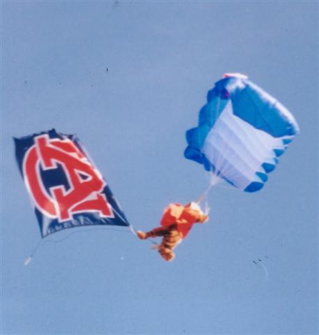

ID:	1099148   Click image for larger version
ID:	1099149   Click image for larger version
ID:	1099150   Click image for larger version

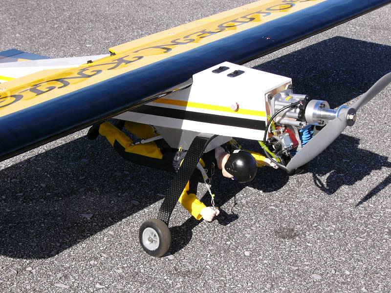

Thanks for the info...I'll try and make some of the events you mentioned. I'm using an Ultra Stick 120, recovered in Golden Knight colors to haul my Golden Knights Jumper. Had 4 more jumps today. Am learning more with every jump.
Gene
ID:	1099879   Click image for larger version
ID:	1099880   Click image for larger version
