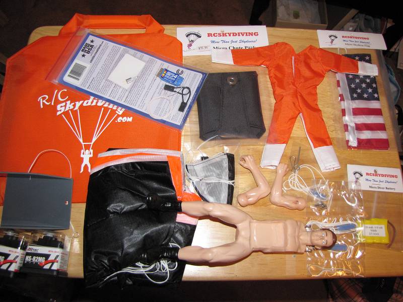

I got a package in the mail yesterday from RCSkydiving.com. Everything looks great. I received the order only 2 weeks after placing it, and that's with all custom color schemes on the parachute, drogue chute, and jumpsuit. I can't wait to assemble this little guy and drop him from a plane. The winds have been blowing 25-35 here lately so I guess it'll be a while before he gets his maiden jump. Thanks, Dave.

Hope you enjoy every moment.
What is the height of the micro diver and when assembled the weight.

I've completed most of the assembly. He is 9 inches tall and 5.25 inches wide when measured from outside the elbows with his arms up. I'll weigh him on some accurate scales when I return to work in a couple of days. Tonight, I plan to solder the battery wires and rig the steering lines. I'm still a little confused about the process. When the instructions refer to clamping the wood to the 2nd inboard rib, am I right to assume that this is where the seam is sewn between the outer cells 1 and 2?

yes, clamp it to where the seems is, or were the lines hook to the chute.
