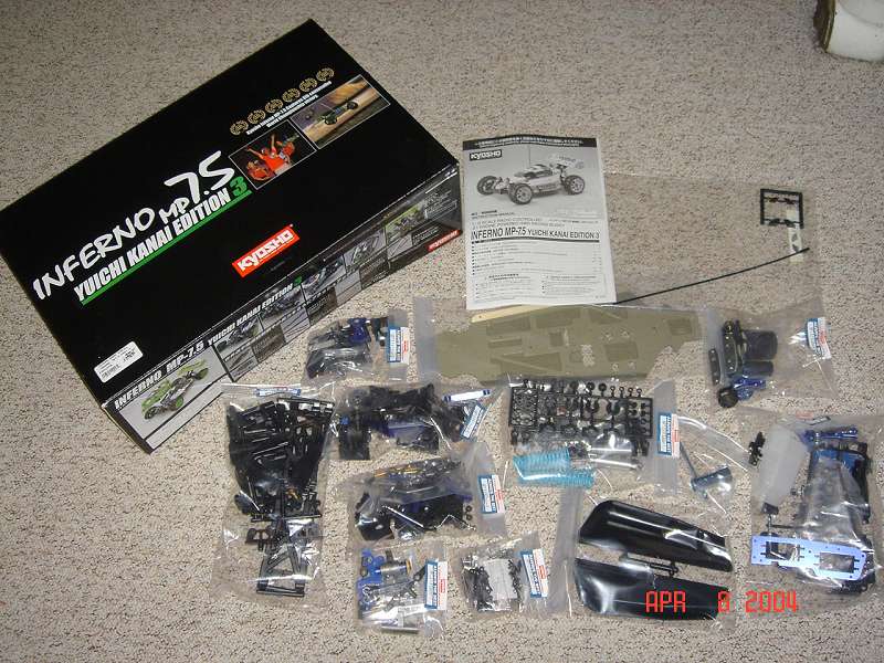

I have a H7 Pro that's just broken in and just recently bought the K3. I'm contemplating whether to sell the H7 or not. I've accumulated some spare parts for it from eBay including the longer chassis. The K3 is still being built, I'm just taking a break because my fingers are so d**n sore! Eventually, after getting used to the K3 and having enough spares, I will get into racing it.
Here's the progress on the K3.....rear differential and rear suspension so far.....only took me about 5 hours to get to this point.... ... sad?
I've had the aluminum parts anodized red 'cause blue just doesn't do it for me. The chassis is still at the shop getting hard anodized and should be ready tomorrow. What do you guys think? Pointers are welcome for building the K3.

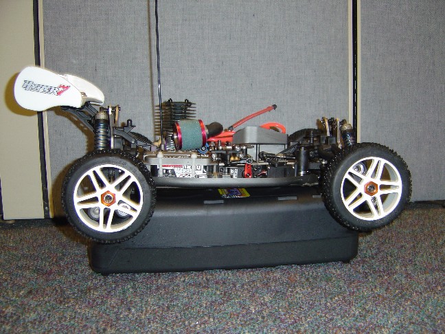

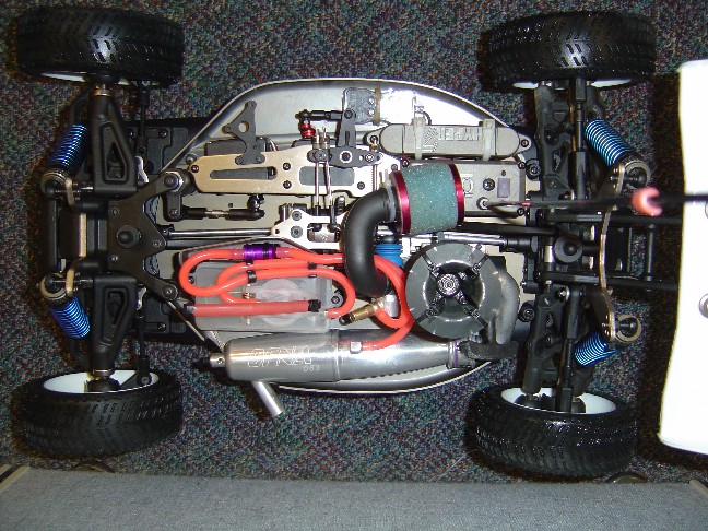

Yup, building a kit is fun. I've had 4 on-road cars and one buggy that were already built when I bought them. The K3 is my first kit that I will be building from the ground up. It's so interesting and fun to put the little things together and see your progress....ahhhh, the satisfaction of enjoying the fruit after the labor...sorta...hehehee....downside is your fingers tend to get sore big time. I can't wait to finish it.

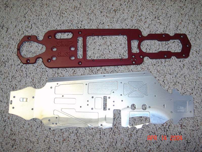

Try looking in your local yellow pages and start there. The place I had my pieces done is local and I've found couple more places around but the shop I used is the cheapest and fastest turn around. You could have them back the same day if you bring them in early enough or if not, they will be ready the next day. The basic charge here is between $50-$65 for the lot, not per pieces. So the many you're having done, the mor practical. Or you can have a buddy anodized his parts at the same as you and you could split the cost. This is my second time using the same shop and so the owner is giving me a little break in price
There are two kinds of anodizing...regular anodizing and hard anodizing. Hard anodizing is twice the cost of the regular and it's supposedly would make the stuff like steel...this is good for the chassis, tower braces and the nut wheels 'cause those take the most abuse.

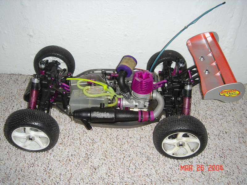

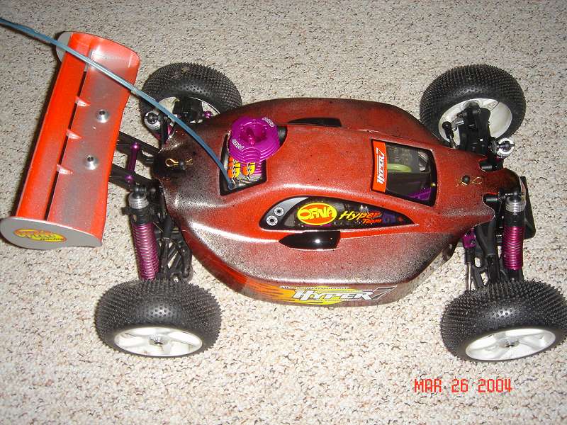

that all depends on a lot of things, out of the box it should do about 35 to 40 mph. i got mine to do about 58 to 60 mph with some modification and it was a 4 port.. here it is before and after my latest mods.. actually check my other post " Hyper before and after " or have a look at my gallery

Whatever you do, DO NOT hard anodized your chassis...regular anodizing is OK. Look what happened to mine. The Slide chassis on top is what it's supposed to be. I had them both hard anodized and the K3 chassis got cooked.
