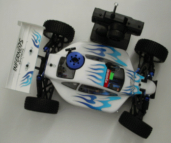

i just bought a 3 shoe-clutch from ebay, and i have installed it on my force .21 engine. When i start my car the engine revs very high but it doen't want to take off. do you know what could be wrong with it

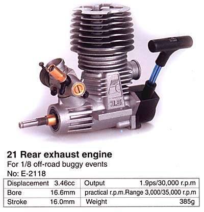

the car is a kyosho inferno 7.5 sport and yes the distance is fine cause the lhs meshed it for me this is a orginal picture of my car last year with none of the hop-ups on it and i have a picture of my engine from my lhs it is off my lhs web site.

Did you have the same problem and that's why you changed the clutch shoes??
Ckeck the set/grub screws that hold the outdrvie cups @ the front and rear gear boxes,,this is a very common thing to come loose on RTRs,,,loctite all these screws too

i changed the clutch shoes because they were plastic, my original metal clutch broke so i put plastic and they were melting the grub screws are fine and i loctited them to

Hold the (4) wheels stationary by pushing down on the car and see if the spur gear will turn. It should NOT turn without it trying to move the car. If it does turn freely when you are holding the tires then it is either an outdrive screw loose or a diff gear(s) is/are blown. Have you taken the center diff out yet to check it ? Hold the spur gear and turn 1 outdrive and the opposite end should counter rotate. If it doesn't......blown diff gear(s).

when i hold down the 4 tyres it dosen't move. i haven't takin out the centre diff yet, it did counter rotate.

i took it down to my lhs and they said it needed some oil in the centre diff that was why it was reving so high
