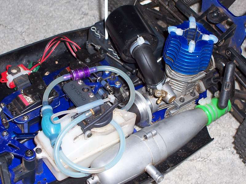

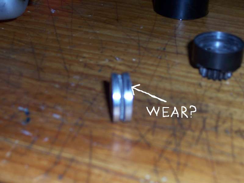

Hi i went to start my car today and it wont start at all yesterday i started it it started fine, what could be wrong with it, i bought a new metal clutch from ebay, i think it might be worn it has black marks on the side of it.

pull out your glow plug, connect your glow ignitor to make sure it still lights up bright orange. if it doesn't, replace it.

and make sure to use fresh fuel. [8D]

the clutch has nothing to do with the car starting up, and if its been used its gonna wear

Whole day????....
Maybe you over primed?.Too much fuel in the motor.
Take glow plug out.
Turn buggy upside down
Turn Flywheel a few rounds and let the piston push all the access fuel out from the glowplug hole.
[ messy job but fast :P ]
Replace plug back in and go..???

do as zimzalahbim suggests. If it doesn't glow try your ignitor on new plug before you trash the other one. Your ignitor could be dead. If you weed the glow plug issues out and it still doesn't start, take your air filter off and makes sure your carb isn't closed. There should be about a 1mm gap on the right side of the slide.
