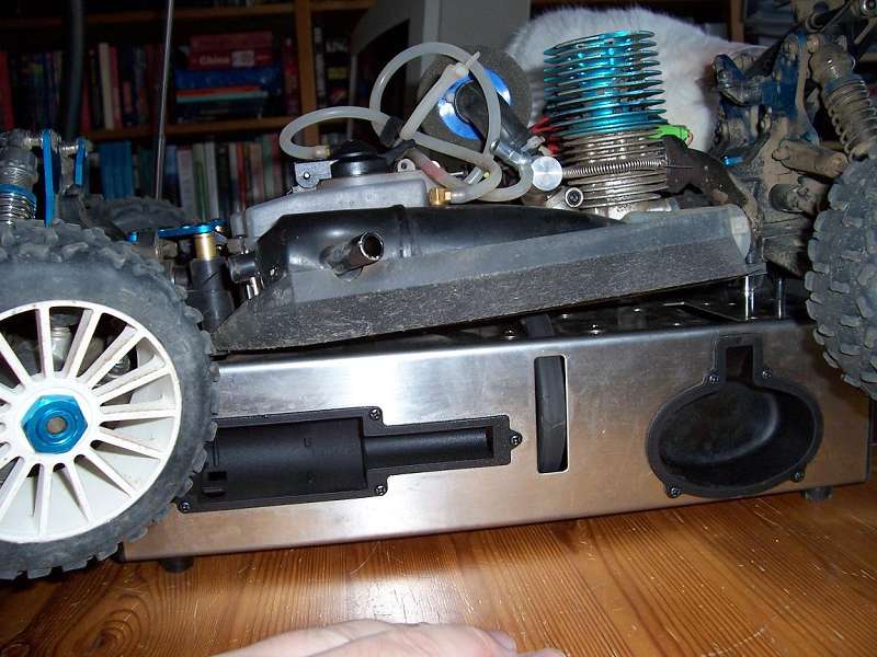

I just got my kyosho kanai 2 (wooooooooooooooo). I cant seem to figure out how you use the starter box. Heres some pics.
Thanks a lot.

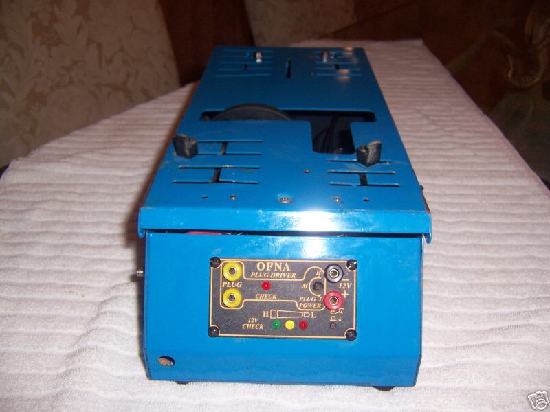

well you can plug two leads "red and black" into a car "real" its battery or just buy a battery for the actul thing there about 16 pounds to about 20 pounds depends on what you want, at the moment i use a yellow box for the car 12v i think but im going to get a battery for it soon saves lugging the yellow box

The kanai looks v.kl and it is much larger than my rc10b3. When I get it running, maby tmoz, I will report on how good it is. After you plug it into the box so it has power what do u do. Do u put the spinny thing in the box to the thing on the engine that you can see through a hole in the chassy.

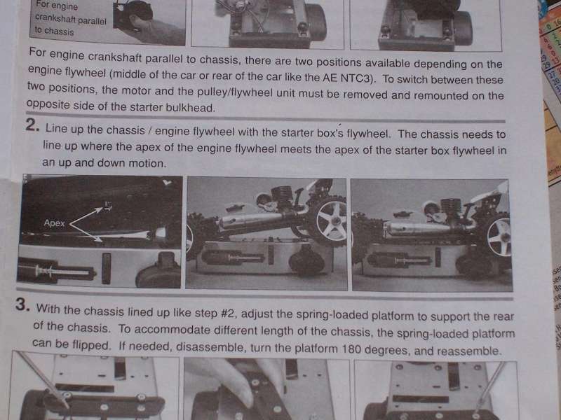

Look at these pictures, maybe they will help.

the bit your on about is the fly wheel, yes you need to aline that up with the starter box then you push down the car with the glowstart them wam there it is going, with my starter box i had to screw them up tight when there alined

That has to be the worst explanation I've ever heard...sorry hyper dude, I know you're only trying to help...crazy, look at the pictures, and figure it out for yourself mate, it's not rocket science...

I think I get it now, all I need now is a 12v. battery and im rtr.
