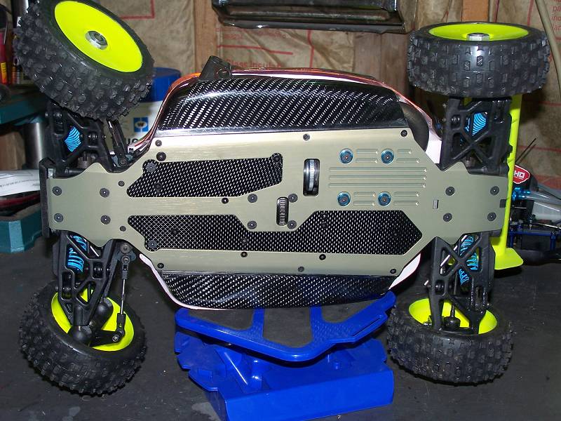

well i got this mugen chassis so i cant decide
ORIGINAL: monster man14
which one is stronger.ni know graphite is lighter
any down falls from that chassis?
Joined: Dec 2004
Posts: 1,193
From: brighton,
MI
you know it dont seem any lighter ...the chassis is 1mm thicker so i think they tried to keep it the same weight as original by milling it out and adding the cf

maybe that chassis will work well, but i know there are potentially many problems. bonding aluminum and CF is always hard. getting the parts to stay bonded and not corrode has been a problem in the past. huge problem: different expansion rates as the chassis heats up from the engine. the chassis is a heatsink for the engine and does expand (alum expands quite a bit) and those two expand differently. maybe none of these problems will be evident, but they are potential problems in that chassis.
your wrong ...the carbon fibre is not bonded to the alumionum the 2 pieces in the chassis are there for rigidity and are held into place by screws holding the componets to the chassis
the side guards are from mugen

The K Factory chassis is, even though it's 1mm thicker, 35 grams lighter than the stock chassis.
