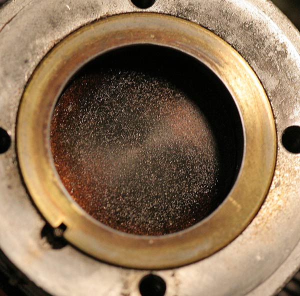

So I was running my car and the buggy cut out and died. I tried restarting her but I noticed I lost compression and there was spray. I looked and saw a screw was missing from the cooling head. I took them all off to find this.
It looks unhealthy but was wondering what you guys think

You really can't tell just by a picture like that. It sounds like the cylinder head was just loose so bolt it back on and make sure there are no compression leaks then try to run it again. A worn out engine runs strong when its cold then just loses all power when the temps come up because it loses compression from the sleeve expanding.

Your piston looks fine by looking at the color.
Take it out and see how far you can push it through. if it goes all the way like on my RG below it's toast.

A loose head and dark piston could be a sign of detonation. Assuming you didn't touch your mixture settings it would probably be a good idea to purge the fuel system and carb before trying to run the engine again. Also make sure that your exhaust system is sealed up good.

First of all - the piston should be dark and is not in itself a sign of detonation. It's a sign of 'good power'.
Now, if you have problems with detonation you will see that the piston has become pitted and the head will not be smooth. It will be kind of dull and somewhat rough.

Here's a close up shot that shows that I think it IS pitted. So likely this is not in good condition then?

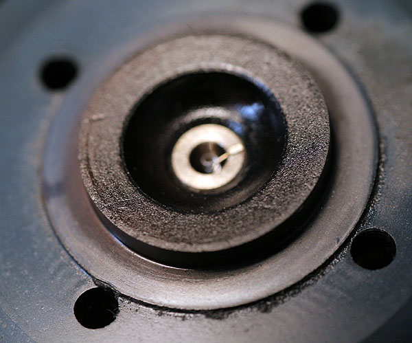

Can you post a pic of the head too?

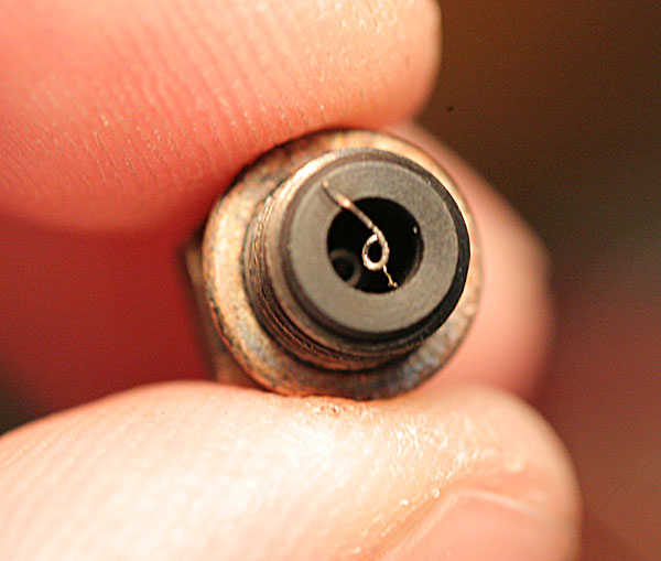

Here is a pic of the head and also the last glow plug that was in there. The glow plug looks like the metal coil is actually broken off.
Any diagnosis based on this info?

Thank you for the pictures of the plug. From that I can see that the plug is completely destroyed. How old is it?
A colder plug would be my first choice and if that doesn't work you should try an extra shim.

The photos of the head and piston top definitely show signs of detonation. Pre-ignition might be a better description for whats happening in that engine, meaning its firing before it should. Excessive heat is what causes pre-ignition. Like some others have mentioned a colder plug would help, I like to use a McCoy MC-9. Make sure you keep the head shim in that came with the engine, a lot of guys will remove this to boost compression, but it also makes the engine run hotter. Higher nitro content in the fuel will also generate more heat and can just make pre-ignition worse. If your running 30% try 25%, that will help too. It is not so much a rich or lean issue. If your running it lean your shortening the life of the engine and blowing plugs, assuming everything else is set right, running lean by itself will not cause the pitting on the head and piston.

From: Charlottesville,
VA
You think those pictures were bad!?
That was a very very mild case. I've seen big chunks of alu taken off in my marine engines due to detonation.
Anyway, hope he gets it going again. Just put in a new plug and fire it up.
My Feedback: (19)
Joined: May 2002
Posts: 432
From: Los Alamos,
NM
Usually you see the pittng on the head or piston, seldom both. Seeing it on both make me think its pretty bad or has been happening for a long time.
I have put holes in motorcycle pistons but its usually from running too lean not detonation.
