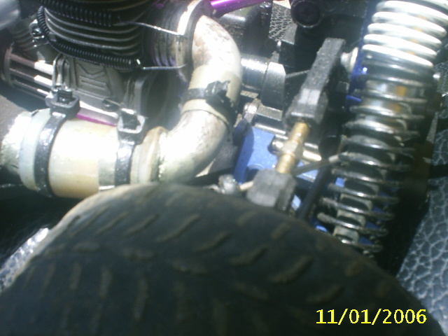

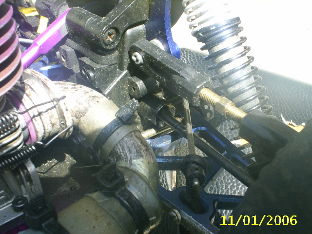

What i'm going to share to you is an idea that came to my mind 3 weeks ago. I call it the Zaint Suspension System hehe :-)
Medium springs at the bottom and hard springs at the top. i have a stiff stance at the back and further more.. your shocks extends to the fullest. However you can adjust the stiffness of your car depending on the length and hardness of the auxillary spring that you're gonna add.
The hard springs at the top starts to function when landing from jumps. this is also applicable to the front since the frt section lands first. oh yes i it performed well to me and i'm sticking to it. well you could just ignore it if you don't appreciate it.

its a good idea but i dont like the fact that theres no droop you always want droop. great idea just some constructive criticism

You are basically making a progressive spring. This is offered by a couple of different companies. I am not sure where to get these springs other than at A Main hobbies. That has been the only place I have seen them at the present.

The biggest issue you are going to have is overall travel. The more spring guides/spaces you put on the shock to handle the change from one spring to the next will reduce the overall shock travel by the width of the spacer/guide. I know it doesnt sound like much but when you talk about doing three different rate springs you will most likely lose close to a 1/4 inch of travel. This will make it a lot easier for the suspension to bottom out putting undue stress on the shock tower, A-arms, and the shock body itself.
For the money you would spend on the extra spring guide/spacers and springs you could easily have purchased the progressive springs from my above post. They come in at least two different ratings, depending on your needs.
As stated before a buddy of mine uses these on his MB5 and they seem to allow for better traction, reduced chance of the chasis bottoming out off of jumps as well as soaking up bumps better dual to its dual rate abilities.
I know its fun to make things but sometimes it just not practical to follow through with them when someone else is already producing a item that is similar to what you are wanting to do and most likely will function as well or better than your design. One of the major design flaws with your idea is the use of two springs. Since you use two different springs it will be harder to keep them aligned for proper suspension travel not to mention get the return rate the same with out some special tools to measure the return rate.
Please dont take this as a knock on your idea it is simply some constructive critism.

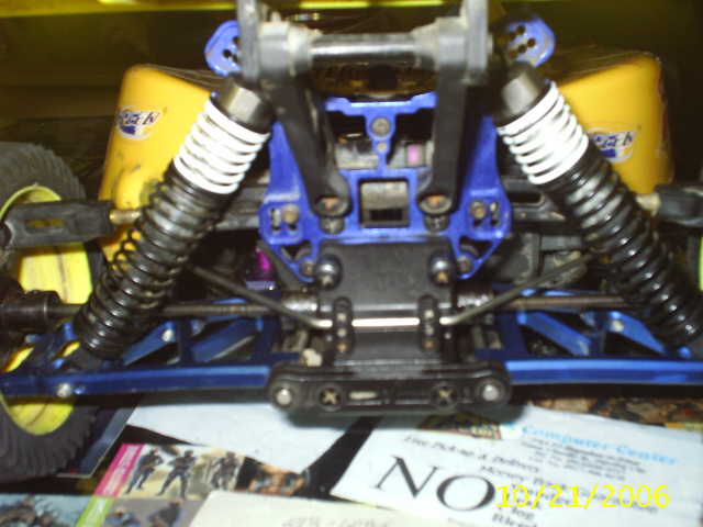

In your third picture you can clearly see you have an alignment issue. The alignment I am talking about is keeping the top spring centered over the bottom spring. In this picture it is easy to see the white spring is not centered over the black spring. If you have any slop between the spring and the shock body it is going to allow the spring to kick out at the weakest point. This point is the area where your two springs meet. You stated you were using some form of a guide to keep the two springs together. I will bet after a short time running your springs this way you will see wear marks on the shock bodies from this guide. This will be caused by the alignment issue.

I don't have problem with the alignment you're talking about.
Look it woks well to me ok. i wouldn't post this in the first place. Well maybe your freind didn't get the right set up correctly. it cannot be done by just one test only. just simply if you don't like it don't do it.
