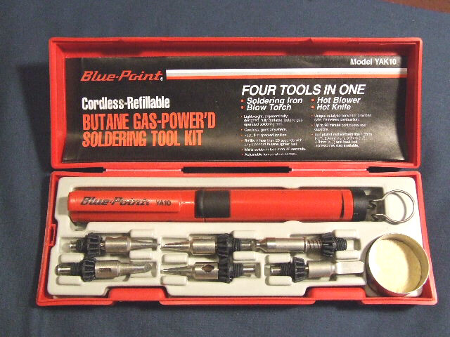

What can I use to break loc-tite from my engine mount? I've tried boiling it in water and over the stove flame, but that doesn't seem to work.

Usually if you hold a soldering-iron to the screw tip it will weaken the bond enough to break it free.

Unfortunately I don't have a soldering iron and the threads are still inside of the mount.

I used one of these when I had the same trouble. Worked great.

a common lighter works well.......of even better one of those blow torque type lights (they cost like 5 bucks) ..........but thats only a good idea for METAL TO METAL contact

This is what i use.

I talked to the Losi techs about this. They recommended just using a CA de-bonder and letting it set for about an hour, so you need to put it on thick or come back and check on it.

I tried the open flame from the stove yesterday but the thing is that the threads (and loc-tite) are still inside of the mount. I guess I'll hold it under the flame a little longer. Thanks guys.

I have been a motorcycle mechinec and machinist for over 35 years and heat is what Loctite recommends to use. I know many use blue and I have found using purple, which is not as strong as blue, works well and is easier to get loose! I have never had anything come loose using purple on my RC vehicles.
