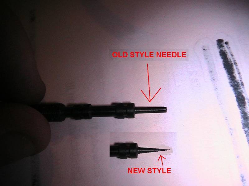

Hi
I am going to go on the assumption that the engine is the Onfa Picco .26 and not the standard Onfa .26 engine.
The carburetor on the Onfa Picco .26 has two known flaws.
1. The o-ring on the high-end needle has a bad habit of getting mangled when it’s installed at the factory. So check the condition of the O-ring on the high-end needle and make sure that the hole the needle goes into is also clean. If the o-ring is mangled you will have to get a new one.
2. The other known problem is with the low-end needle itself, older versions of the engine came with a black Low-end needle that had a squared off needle head (see image below). The newer engines come with a silver low-end needle that comes to a point at the end instead of being squared off. If you have the old style low-end needle you will have to contact Ofna and see if they can send you the new style.
You will also want to apply some high temp RTV sealant in-between the Carb and the block, and in-between the back plate and the back of the engine block to help eliminate air leaks.
The high-end needle on my engine is 5 1/4 turns out, I don’t know how many turns out my low-end needle is but see the picture below for an idea of how far it is out.
Posts: 2,116
From: leicester, UNITED KINGDOM
Firstly I would say that it is just too rich. Leaning out the Hish speed needle (HSN) won't stop it form stalling. You need to lean out the LSN (low speed needle) slightly. You just want to get the thing so when you apply throttle it doesn't die. Turn it 1/12th turn clockwise and try it again. If it works and you get it running (assuming it has already been broken in) start tuning the HSN a little. If not turn the LSN again (you don't want to tune the LSN first toatlly just enough to allow it to pull off without stalling). Once you have acheived this and have tuned the HSN then you can move and tune you LSN for accelleration. you do this by pinching the fuel tube and checking what happens before the engine dies. you want it to run for 3-5 seconds with a slight increase in revs before it dies. more than this and its too rich, less and too lean.

I had to do a little research to find out what motor it is. Its a Ofna Force .26 . I plan on taking it apart and sealing the motor this weekend and i'll take a look at all the o-rings and see if there is any cuts on them. I'll let you know how that goes.
