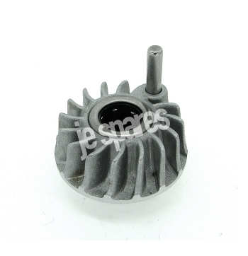

So what would that do then???? I've noticed they sell a turbo fan one way bearing too.... What does it all do...

ORIGINAL: SManMTB
Turbo fan one way bearing!!!??? what is that? The term doesn't make any sense, just like headlight fluid.
Ah...you not heard of that!
Old 01-14-2008 | 01:36 PM
SManMTB's Avatar
Joined: Apr 2005
Posts: 5,253
From: Charlottesville, VA
Default RE: Turbo head button??
haha, ok. what's it for?
Old 01-14-2008 | 01:48 PM
Anthoop's Avatar
Joined: Feb 2007
Posts: 2,324
From: Somerset, UNITED KINGDOM
Well obviously it incorporates the one way bearing plus this is what is referred to as the "turbo" part....i'm presuming that the theory is that the fan forces the mixture up into port channels...maybe they thought crankcase pressure supplied by the piston wasn't enough![&:]

that turbo fan one way bearing came in my hyper 21 8 port turbo its ment to give better runtimes and smoother power band to be honest i dont think it did very much.

The best way to get better power band and run times is to get rid of the one way bearing, pullstart/roto start plate, and go to the choice of the pro's. A starter box. Removing the drag and weight of these parts will help increase performance.

The turbofan acts in the same way as a supercharger in a 1:1, except of being driven by a belt, it's drivene directly by the crank and is there to compensate for the loss of power due to the drag of the pullstart parts, but it doesn't, it really is just a fancy one way bearing to crank adaptor, which is the most common failure on these engines due to the poor material used, when the mills flooded and youtry to turn it over, it is this part that cracks and splays open allowing the oneway to revolve inside it and thus NOT turn the engine over. The only thing the fan really does is stir the mixture up a little more than a normal engine and so creates a better mix of fuel/air to enter the chamber.
