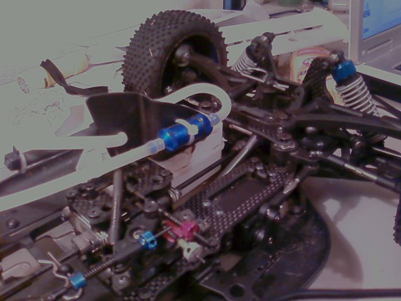

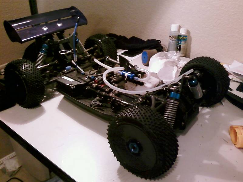

Well, I took the Turmoil out again! This time, the GF took her Mayhem out too!
First of all, the Go .21 5-port (5-port 5 port) is a beast! I have it running about 200 degrees on 20% nitro and it is doing great. It seems to like alot of fuel and runs best when shooting out lots of smoke. Right now I have the tune on the rich side, enough that it fails the "30 second load up" test miserably, but I am not going to mess with it too much because as long as you keep it moving it picks up nicely. Additionally, I havent removed the break-in shim yet, which Ill probably do before I take it out again. Even today on about the 8th tank I still couldnt get the engine to crank without getting stuck at TDC a few times. I still need to get a pipe for my engine. Im still using the old stock (unchambered) Storm pipe so I think I can get a bit more out of it with a real tuned pipe.
Second of all, her Toki .21 engine (ebay, ~$77 shipped I believe) is actually a pretty decent engine. She had a bad WOT runaway on her 3rd tank (radio interference), resulting in a broken arm / bent shock shaft (I had to chase it down the street and the only reason it stopped going is because the arm came off after hitting and ramping over a ~8" curb at WOT), but I still had to shut the engine off myself). Thus, I am not sure how long the engine will last. For now it seems OK, though. After getting it tuned pretty well, it does run pretty decently and I still recommend it for a cheap budget engine.
As far as the Turmoil goes, it is still doing great. Other than her runaway we havent broken anything. I got to do some jumps today, using a small pile of wood chips, resulting in air about 3' high and 12'-15' far. It flew pretty well considering the shoddy, make-shift nature of the ramp. Mostly all we did was run around a grass / dirt field (with its share of pine cones and large sticks), and they did pretty well. With my droops set so that the arms cant go below parallel, traction rolling wasnt much of a problem even on grass, and I didnt notice anything related to it being it too low.
Here's a pic of my Turmoil and her Mayhem, as well as two closeups under the body of my Turmoil.

When you described your all-black colour scheme i thought it would look crap. Then i saw the pics and reckon it looks awesome! Very mean and a little like those spy shots you see of a soon to be released real car.

Heh thanks man.
Yeah we just took the engines and radio trays off and hosed each chassis off. I cleaned the engines separely and she cleaned the radio trays. This time around im glad I left the body off, because the filter came off on what was going to be the last jump anyways heh.
