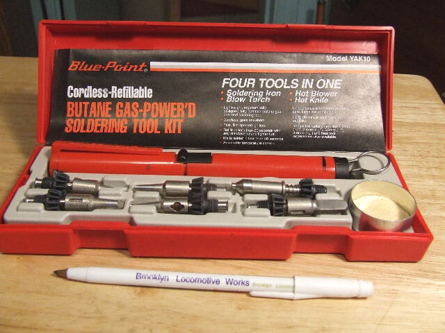

Shocking the screw actually works pretty well.....if you have an All alum body driver....you can SMACK it with a set of plyers or a small hammer and that ushally breaks it free. heat is another option that works most of the time.....a small butane torch or even a soldering iron can be used to heat the screw and help break the Loctite loose.

Heat is what breaks the bound on loctite! If you go to there site you will see this is how they recommend to break the bound. I all so mostly use purple Loctite as it is made for small fasteners and is much easier to take apart. If you have really good servos they should be moister resistant and I rarely take mine out when cleaning unless I am doing a major clean up and service. Now I do not recommend submerging or socking. I use either Wild Cat extreme cleaner or denatured alcohol.
This is what I use to heat up screws with loctite on them.
