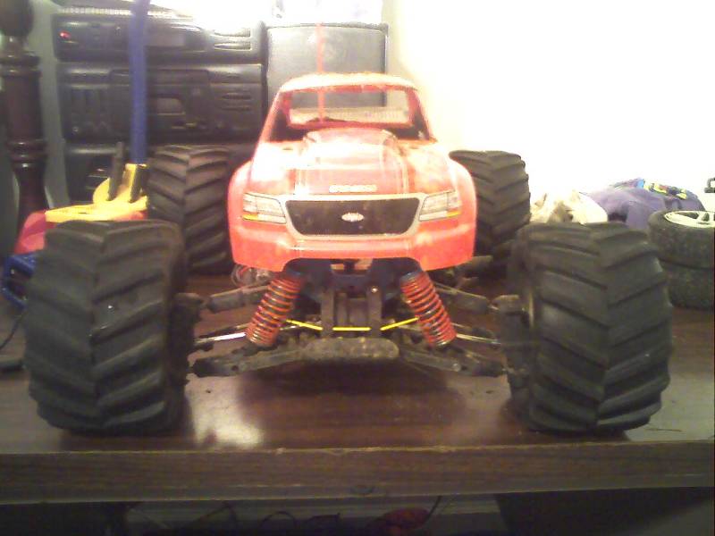

Alright, i took some pictures of it on my old t-maxx wheels. The offset on them is nothing compared to Ofna monster pirate wheels and tires, which is what i would most likely be running. Several of the pictures, I set the tires out about how i figured the stance would be on it. I think it would work great with some savage body mounts and a nice savage body with a locked center diff, and MP tires and wheels Me and my ideas. The last picture shows there is plenty of steering clearence, and that is with the maxx wheels all the way on and not set out with an offset like the Pirate wheels would. Im wishing i hadnt of bought those new buggy wheels and tires now. Anyone want to buy a set?

Don't you need hex adapters?

For the T-maxx wheels i would have. I made my own adapters, and tried it for about 1/4 tank and realized i didnt want to burn up my clutch. Gearing was entirely too high. So i did the smart thing and traded the buggy to another MT[8D]

You already have 17mm hubs, so find some wheels with 17mm hubs and a lot of offset to compensate for the shorter a-arms of a buggy, and they should fit right on. Thats why i was going to use monster pirate wheels. 17mm hubs, and lots of backspacing.
