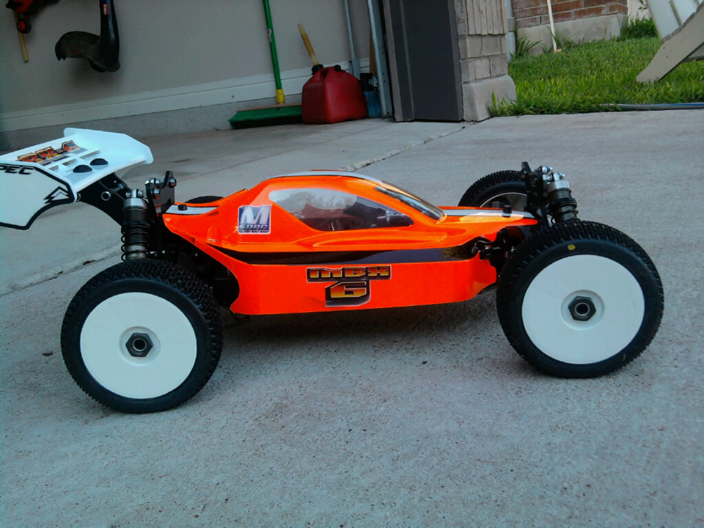

Old 11-01-2009 | 10:53 PM
Joined: Jan 2009
Posts: 629
From: Austin, TX
Default RE: XRay XB808 thread.
I didn't copy your green after all. I went with orange. I kinda used your stripe a little.

Old 11-02-2009 | 06:32 AM
Zerodefect's Avatar
Joined: Jun 2008
Posts: 120
From: Mentor, OH
Yeah, that came out nice! Love the side stripe to.
Your engine fell off?

Old 11-04-2009 | 11:00 AM
Joined: Jan 2009
Posts: 629
From: Austin, TX
I got a little anxious and painted before putting in the engine.
I'll be testing it tonight, and racing it on Saturday.
