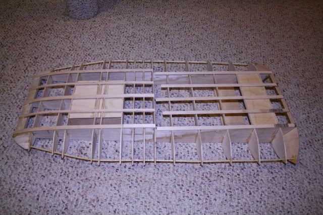

I have a little work to do on the nose to get the right shape and contour - The plywood doesnt like compound bends, so I'm hoping to get the bow rounded just right so the plywood will lay flat and not require a "Y" cut like the big kami did. I have a backup plan if needed. First pic is a better side-by-side to the original .60/.90 sized Kami.
This is the bottom of the frame. The whole frame weighs roughly 8-10oz. Maybe less.
I have the prop line set up to be exactly 1/3 total length measured from the transom. So far, the frame balances almost perfectly on the prop line. That really surprised me.

I used poplar dowels around the perimeter for strength. The bow is all balsa. So far it still balances pretty well, and weight is right around 14oz as pictured.

I have the bottom framing done now. I have 1 piece of hardwood I have to glue in for the trailing edge of the rake (step), but I will do that at the same time the skin goes on. Its [mostly] straight and seems strong enough to run at least once. Maybe twice. Beyond that, is anyone's guess.
I'm setting the radio box up similar to the other Kamikaze. Simple and effective.
I have the skin ribbing to do on the top, and build the engine stand. Coming along well, I think..

Skin ribbing on top is done now. Whole frame is sanded down and almost ready for skin. I need to mount the electronics and get the cables glued in and soldered. Having a hard time sorting out the engine mount - I wanted to mount the engine so the weight of the engine itself is balanced to the mount, but I will probably have to use a Radial mount for that. I might mount it upright to start with and make a new mount later using a radial mount. The jury is still out on that one.
Anyway.. a pic of the progress..
