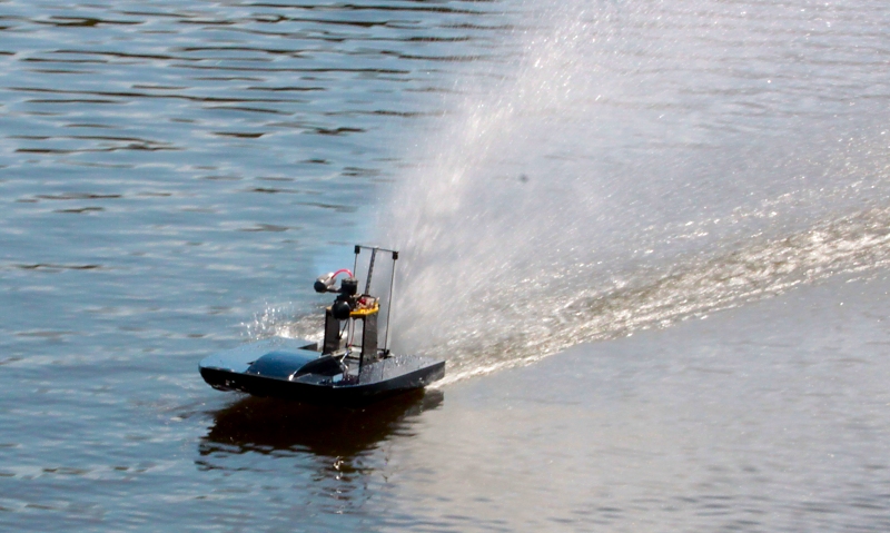

Jeremy_H's Avatar
Joined: Aug 2013
Posts: 444
Perspective :-) :
10cc engine, 16lb boat:
Old 08-31-2014 | 03:24 PM
arcdude's Avatar
Joined: Dec 2013
Posts: 432
I stand corrected on the weight, may not be too heavy after all
