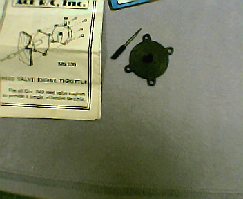

This is a throttle for a reed valve engine, like the Babe Bee, Golden Bee and Black Widow, that use the integral fuel tank.
It is basically a ground needle and backplate with a built in needle guide.
With the regular needle valve set on the engine, this second needle, controlled by a servo and wire hook up, closes and opens the intake venturi of the engine, which is located inside the fuel tank. This in effect, varies the amount of air allowed into the venturi. It acts just like a regular needle valve does, with the exception that it restrics the amount of air, rather than the amount of fuel.

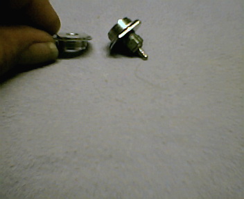

Here is a GloBee head and insert.
What is unique, other than it's two piece design, is the higher compression it creates as well as the 'flat' glo coil. This was the 'must have' many years ago for all out speed and performance.
