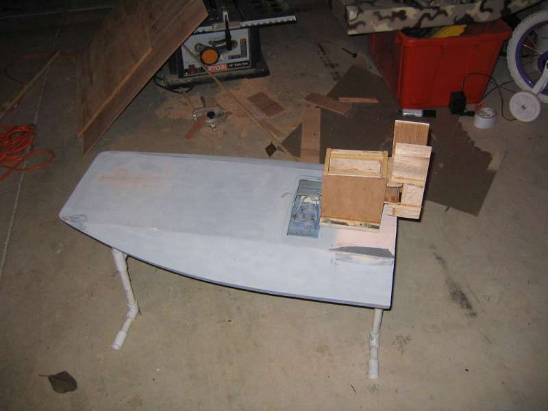

Alright guys, so about 5 years ago I purchased a big swamp buggy, and I had finished the basic construction of the boat with very few problems. Anyhow, I have made no more progress after that. I now want to get this thing finished, and I want to do it right. The main thing that I am confused about is which type of glass/paint/filler/sanding etc etc to Use on the wood of the boat in order to have a great water seal, plus a very smooth and shiny look. In the past I had laid a coat of finishing resin all over the boat to seal all of the seams and the wood, but in some places there are still some gaps that need to be filled, and in some areas where I have sanded, the wood grain is exposed. The paint in the picture is some krylon paint that I put on it a long time ago, and I was thinking it would be best for me to sand all the way down to the resin/wood and do this the right way. So if anyone has any suggestions at all on what i should do to 1)remove the current paint, 2) fill all of the gaps and waterproof the entire boat, and 3)paint the boat two tone with a nice enamel finish- Then please feel free to offer some help. This is my first Airboat and I am pretty confused about the glass/sanding/filler/paint/etc process. Thanks

If you have cracks and gaps you can use micro balloons or simply add some saw dust to your epoxy. To fill big gaps I would use a quick setting epoxy in that area only , then sand, then apply the sealing coat. With wood you can use epoxy or polyester resins.
I would just sand the paint down as much as possible then just primer. Use an enamel paint, enamel is fuel proof. To protect the finish either coat it with a clear enamel or just lay a coat of epoxy over the paint.
For a two tone. Paint your lightest color first. Allow to cure. Tape off area that you don't want painted with a low tack painters tape. Then spray the other color.

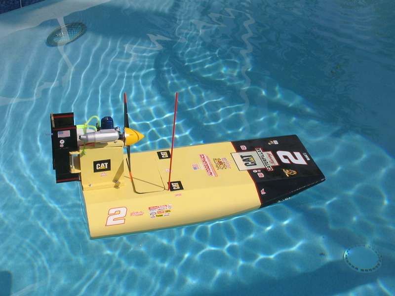

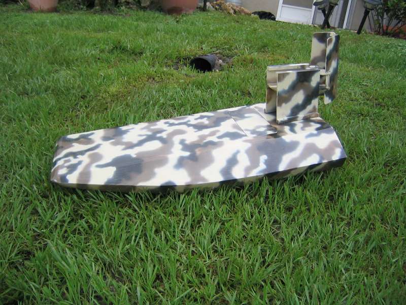

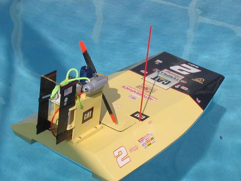

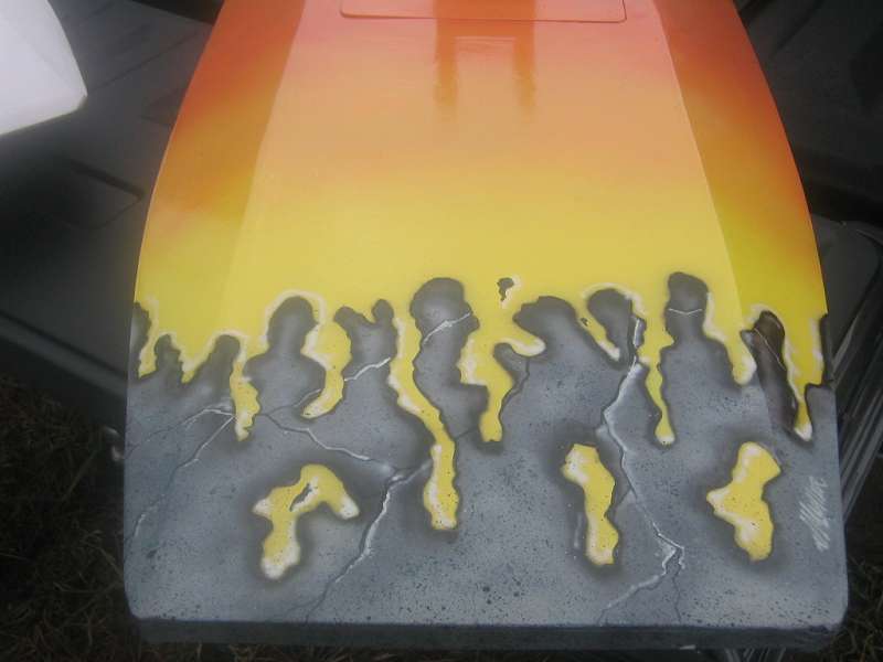

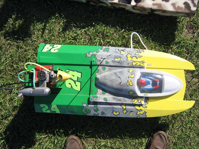

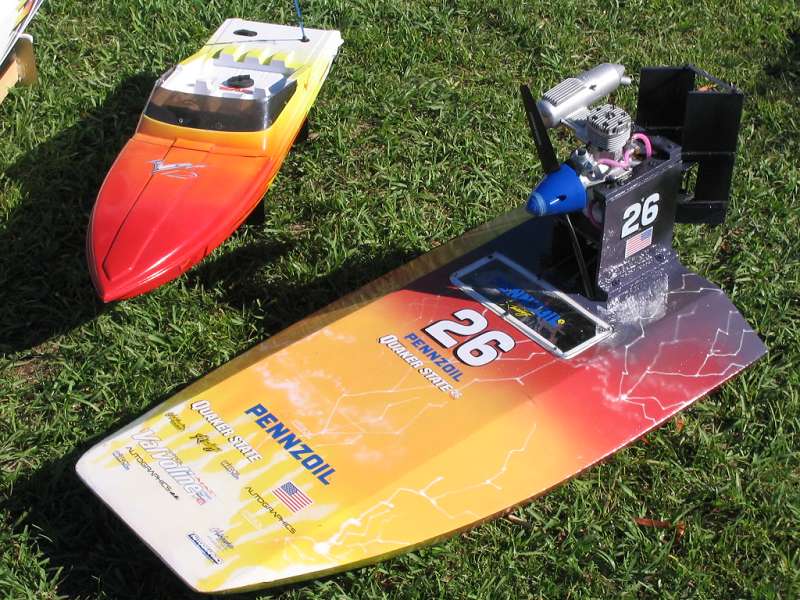

BOY THIS PIC LOOKS FAMILIAR,,,IVE PAINTED SIX SWAMP BUGGYS, ALL OF THEM I USE AUTO BODY FILLER. THEN I USE AUTO BODY PRIMER. IT WORKS GREAT. SEE THE PICS ATTACHED. GOOD LUCK!

HERE IS JUST A FEW MORE PICS

"bondo" is what I used. but I sealed any cracks with 30 min (2) part epoxy first. Once I sprayed primer, with at least two layers I light sanded it down to smooth.
With this method I used oil base paints with a heavy coat of poly. (note: the poly takes a good 3 weeks to dry inside and out.)
