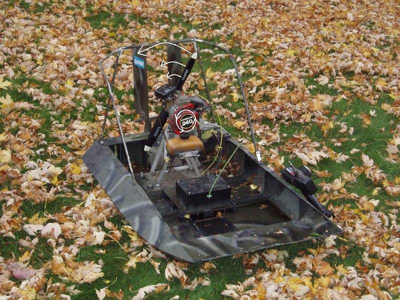

I used an old homelite chainsaw engine.(about 35 cc)??...has plenty of power , weight wasn't an issue so I was able to leave on the pull starter.

standing in back of the boat, facing foreward, the engine spins clockwise. (a pusher prop would make the boat go backward)

18 cc ?? Not sure, depends on where you want to run it. ANY engine will push a boat through the water, but if you want to run on land, a larger engine is the way to go. It also depends on the size/weight of your boat. on mine i originally had a 20cc weedeater engine, moved fine on water but would not move on land, so I went with the chainsaw.
No, as i said, a pusher prop will make my boat go backward, now if the engine were in a puller type set-up, a pusher prop would be the correct prop.
a chain saw engine spins opposite of ....say....an r/c airplane engine. I hope I didn't confuse you more[&:]
basically, mine is a pusher type set-up with a puller type prop.....prop mounted backward
