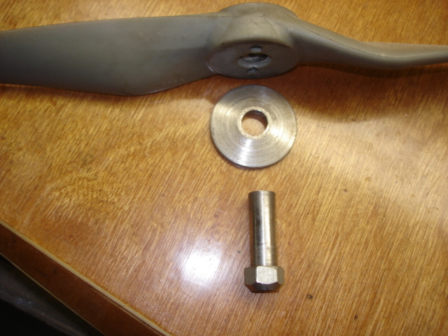

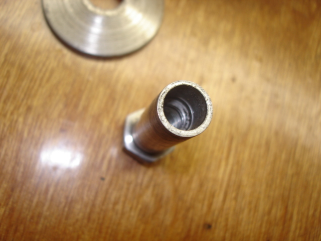

Do you know anyone that has a lathe? I had a shoulder nut made for one of my projects one time. Basically what you would do is ream the prop hole out bigger and make an elongated nut that will screw onto the threads yet stick past the prop. does this make sense?
I'll find it and post a pic.

Here are the pics.

thanks for the replies guys i will get a 9x6 and see, if not i haven't got access to a lathe but i work in the auto industry so might be able to find something like that nut that i can get to fit. The engine was given to me by an old neighbor about 10 years ago, he was running it in a stock car, so that might be why he cut it down? The engine has great compression so i am interested to see how it runs.
