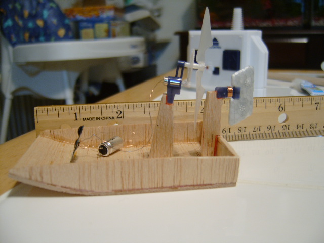

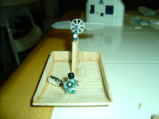

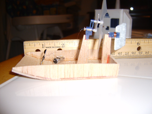

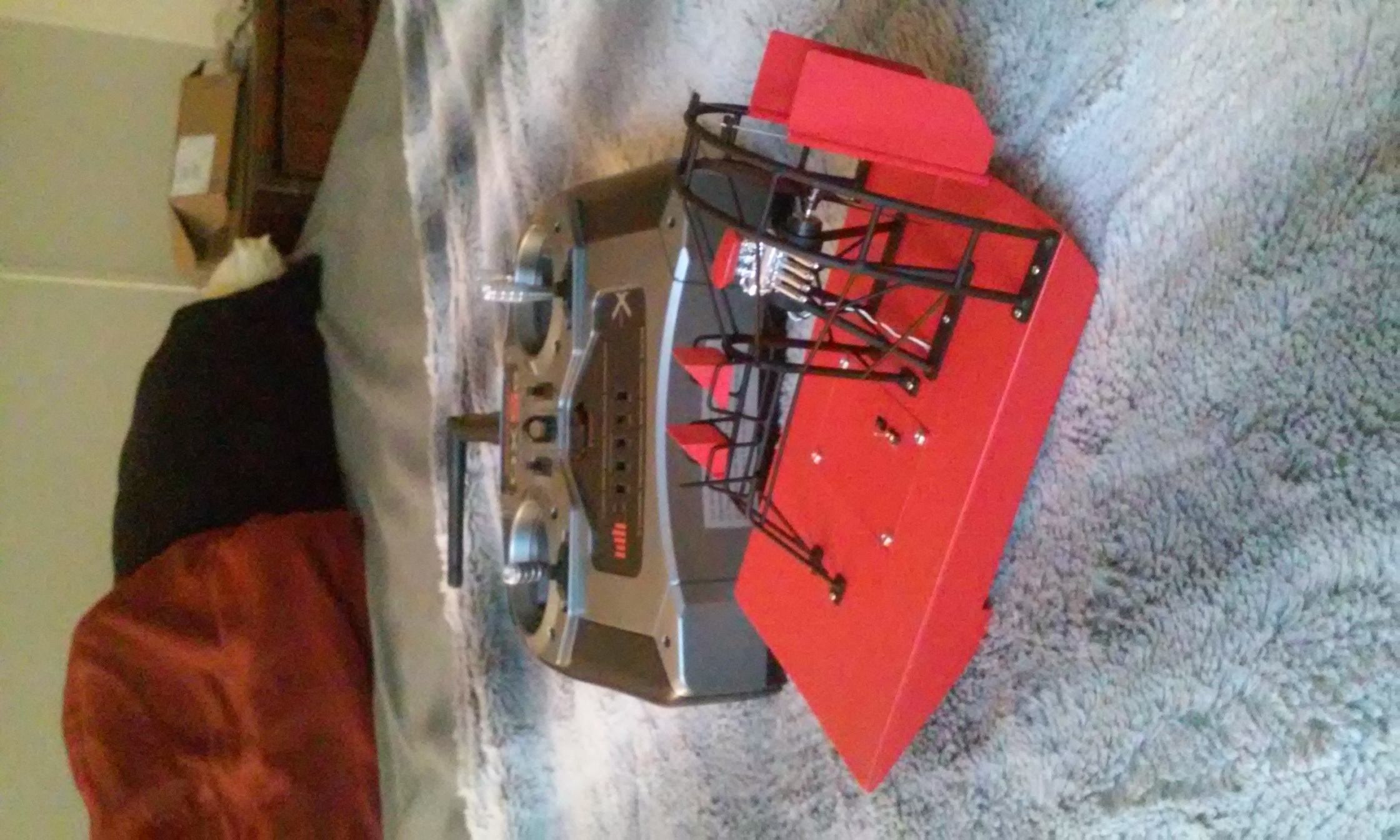

im gonna try and post some pics of a balsa airboat i made using micro tomy aero soarer guts (pager motor, gear reduction prop drive, i.r. controlled, and bang bang rudder). it does go on the floor, albeit really slow, i havent tried it in the sink yet because i dont have the bottom of the hull waterproofed... the dimensions are as follows: 4" long, 2.5" wide, and the prop is 1.5". what would be a good and extremely light way to waterproof? just having fun!!

neat looking boat. How much run time you get with that capacitor
You can always use packing tape to tape your hull to seal it. it wont add that much weight at all

Take some poly resin ( normal fibreglass resin ) and a paint brush , add a little acetone to the resin BEFORE adding the hardener , then add the hardner and mix .. then take the paintbrush and put on a LIGHT coating ...
Your done .

Or you can get your self some regular wood lacquer at any hardware store and paint on a few coats.

thanks for the replies guys, i think ill try packing tape first, and see if itll even pop up on plane!! as for the cap, it sucks, i might get 15 seconds if i charge it twice.. i thought about changing to the lipo like some guys are doing, but i dont wanna spend any more on this lil thing.. plus i dont think itll plane out or turn real good.
