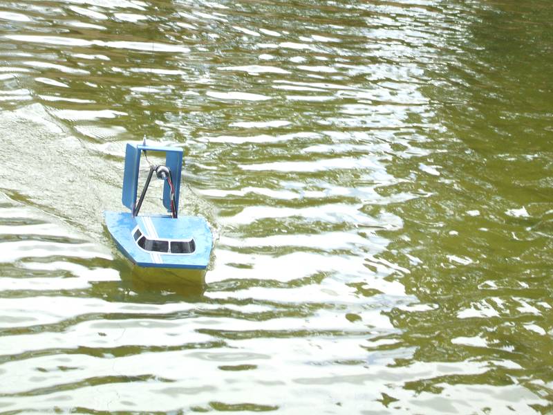

The boat is finished and I have spent several nice afternoons with my kids riding it. On 2S LiPo it is acceptable but on 3S it "flyes". When it is fully charged it is way too much power, but a lot, LOT fun ...
Some photos:
Some photos:

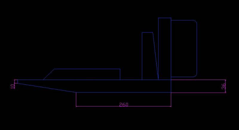

This thread is called "Basic concepts of airboat" because I would like to learn them from you, more experienced guys.
My experience with this boat:
1. It is pretty fast
2. In curves it slides nicely, no intention to flip over even at top speed
3. When it slides at top speed, sometimes it is stopped suddenly, as if it hitted something laterally. The rake is 30º. SHOULD I INCREASE IT A LITTLE BIT? I do not want to flip it over.
4. Sometimes happen (when the boat is moving relatively slowly): if too much rudder is applied, the boat starts to turn around (without moving forward) and DIVING the inner front corner. I see two possible causes: A/ The hull is too low (only 3,5 cm)
B/ The rake below the front part is too long (see picture below)
Your opinion?
5/ Never happened on 2S battery, but sometimes on 3S battery: If the boat is quit and full throttle is applied, the nose dives and the boat goes almost as submarine. Easy reply would be (Do not apply full throttle when the boat is quiet ..)
I think that the causes are the same as in the point 4.
I am asking this because would like to make a V2. I consider:
- maintain the lenght and width
- make the hull higher (how much?)
- Rudder sensitivity is OK, even they could be smaller. What effect would have if I make them lower (and the same lenght). As it is now, the boat leans correctly inside the curve.
Rudder:
Pinky, could you explain more on "You can angel the rudders in at the top if you wish this may help in the terns by making the boat lean more like flaps on a plane" ?
Your opinion?
Rudder:

What this will do is the one rudder when turned will force part of the thrust form the prop down and the other rudder will force some of the thrust from the prop up.
This creates a torque in the hull from back to front making the hull lean into a corner more, working similar to a plain if one flap was up and the other down creating a barrel role effect.
The sudden stop when turning you mention is form the sides of the hull catching the water a more angled side would stop this

The propeller I use is 8x6.
This boat "flies" with 3S lipo.
Marian.
PS. Any suggestions on improvements? I need your help ...
