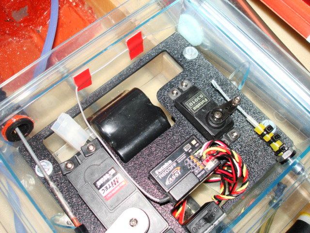

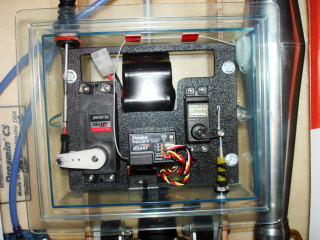

These are from Warehouse Hobbies. Works perfectly, seals great with radio box tape.

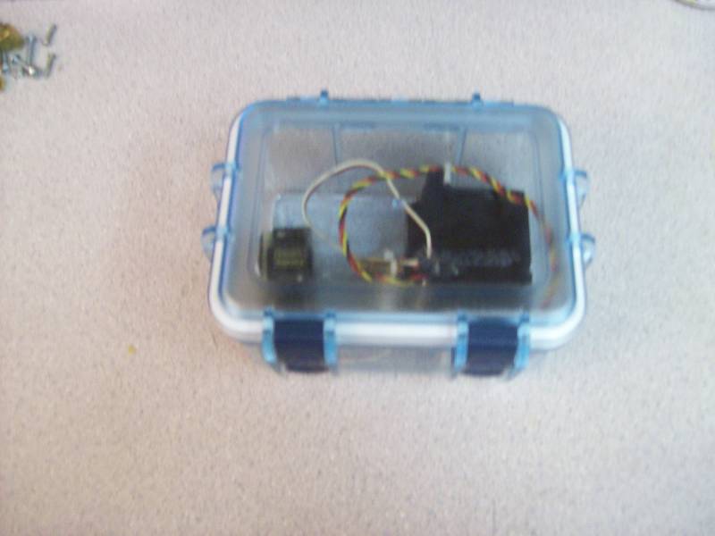

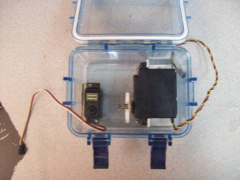

picked up a watertight box made by outdoor products at walmart. i put it under a foot of water for an hour and no leaks. it wil work good for a gasser airboat. all i will need to do now is work on making a good seal for the control lines. if any one has any ideas i would like to read them. rather stay away from using grease. thanks dreamin hemi for the tip.

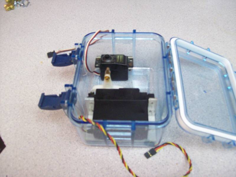

worked on the box a little bit and it looks like its going to be tight if i use 1/4 scale servos. its not as deep as i would like it to be but i think i can make it work.
Old 02-14-2009 | 05:36 PM
greygoose81's Avatar
Joined: Oct 2008
Posts: 236
From: gainesville, FL
Default RE: servo boxes
tight fit
