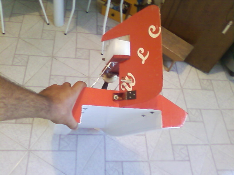

pics my boat
I think if it is not better to use two rudders out of the water

Carlosam, you need to decide if you want your boat to run on land and water or just water. If you use water rudders you will get better control, but you will not be able to run it on land. As for engine angle try to set the engine level with the waterline and straight with the centerline of the boat. Most of the time instead of using different angle offsets I just use a little trim in the rudder to compensate for running in a straight line. To set the hull angle you will have to shim the front or back of the engine to get the hull to ride like you want it to. Dennis
And you wont be able to run through water that is laden with weeds and Lilly pads.

It is, therefore, that I think about the use with the rudder out of the water.
I am thinking about the use of two rudders instead of one. Will there be improvement with two rudders?
Old 05-15-2009 | 10:29 AM
Joined: Oct 2006
Posts: 442
From: Cocoa, FL
Default RE: Question about thrust?
Yes. The vast majority of the r/c airboats are dual rudder and I have never seen a full size airboat with just one rudder. Two will definately give you better control. Dennis
