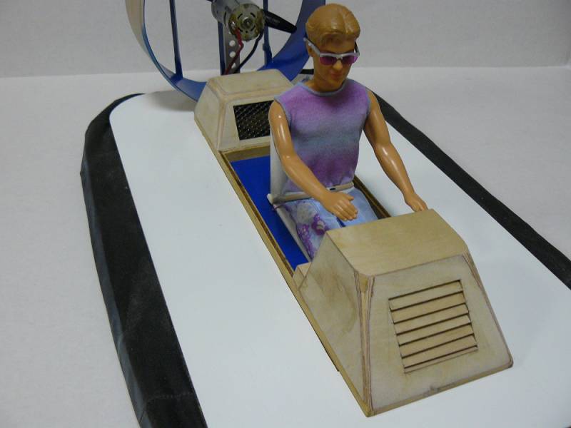

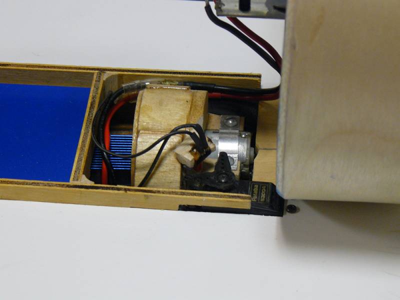

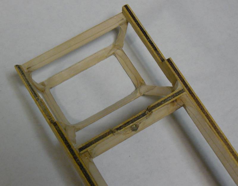

Not much building this past weekend - just a lot of prepping and painting! Let me tell you, I am very pleased with the Krylon paints that I just bought. I usualy use Rust-Oleum, which are about eight-ten bucks a can, while these krylon cans only cost me 2 dollars each! Their spray nozzle is 100% better than the crap rust-oleum puts on their cans, and the paint dries in record time (about 15 mins compared to 45 for R.O.). I also like how smooth it lays down, even with an impatient painter like me who likes to spray two heavy coats instead of four light ones

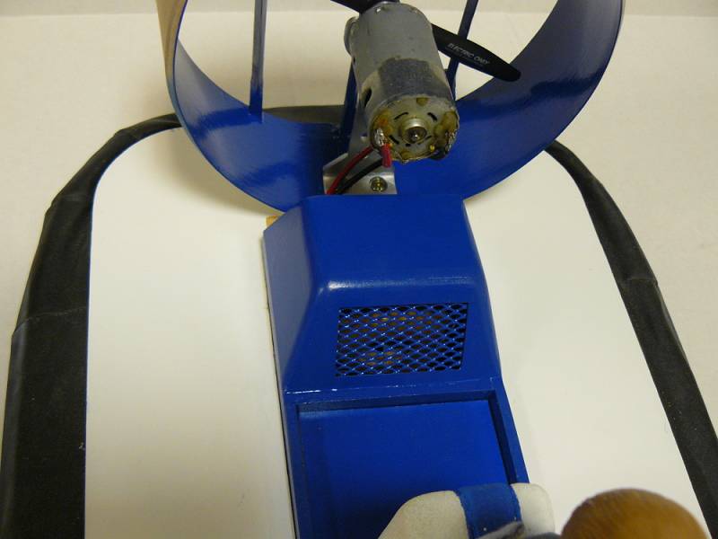

On thing that I did build was a switch that controlled my lift motors. This is operated by the steering servo, which shuts off and turns on the fans at the extreme points in its rotation. If this gets annoying when I am running it, I can just take that switch and flip it so I can turn it on/off manualy. After testing my mechanism (it was successful and I am happy with it) I hooked up the forward motor and noticed a serious dropoff in the performance of the fans - DUH! I should have thought of this before but I never really got to it. The combined amp draw was more than the Nimh battery could provide so performance dropped.What was my solution? Drop in a lipo of course!
After that treatment, there was no visible change in performance whether I was on or off throttle. Also, the craft is quite a bit lighter due to the removal of the Nimh brick... now it is slightly imbalanced as the back sags under the weight of the motor and the front raises and starts loosing air. To remedy this, I ended up moving the lipo as far forward as I could, and that helped a tad but not enough... I will see how I will solve this (add weight to the front, or make the back lighter) I did some test runs around the house and the craft can moveout fairly quickly and easily went over 1/2" obstacles (one of which happened to be my sleeping cat's tail - he was slightly perturbed). Smooth floors were the best ground to go over, yet the hovercraft could even master the coarse 1/2" carpet in the living room when it was at speed. Still no steering, so I did have a few crashes when I got trigger happy, but the craft is very strong and suffered no damage.
on a side note - when I painted the top of the hull white, I only masked the first inch of the skirt and tucked the rest under. That was a slight mistake as there is now a line of overspray on it and it is not coming off - however, I don't really mind as it looks kinda cool IMO. That is the one flaw of the weekend (aside from the time when I ran the propeller without the stand bolted down and added some black marks to the paint
After that treatment, there was no visible change in performance whether I was on or off throttle. Also, the craft is quite a bit lighter due to the removal of the Nimh brick... now it is slightly imbalanced as the back sags under the weight of the motor and the front raises and starts loosing air. To remedy this, I ended up moving the lipo as far forward as I could, and that helped a tad but not enough... I will see how I will solve this (add weight to the front, or make the back lighter) I did some test runs around the house and the craft can moveout fairly quickly and easily went over 1/2" obstacles (one of which happened to be my sleeping cat's tail - he was slightly perturbed). Smooth floors were the best ground to go over, yet the hovercraft could even master the coarse 1/2" carpet in the living room when it was at speed. Still no steering, so I did have a few crashes when I got trigger happy, but the craft is very strong and suffered no damage.on a side note - when I painted the top of the hull white, I only masked the first inch of the skirt and tucked the rest under. That was a slight mistake as there is now a line of overspray on it and it is not coming off - however, I don't really mind as it looks kinda cool IMO. That is the one flaw of the weekend (aside from the time when I ran the propeller without the stand bolted down and added some black marks to the paint

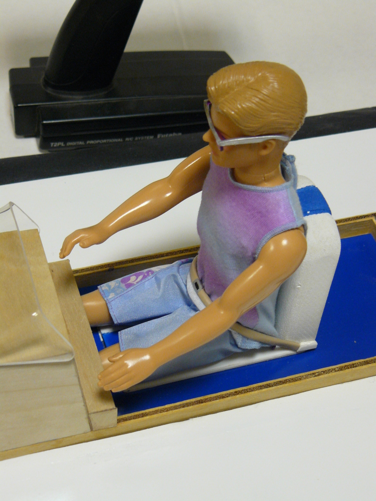

well, that may be a bit too far... LOL, I can't even drive yet!
I just have a lot of time on my hands (the one TV that we have in the house is constantly hogged by my sister and her silly "hannah montana" crap)
and I also have a workshop in the basement - a privelidge that not many kids have.
BTW, I am working on the seat for Ken right now... he seems to be complaining about a sore back lately

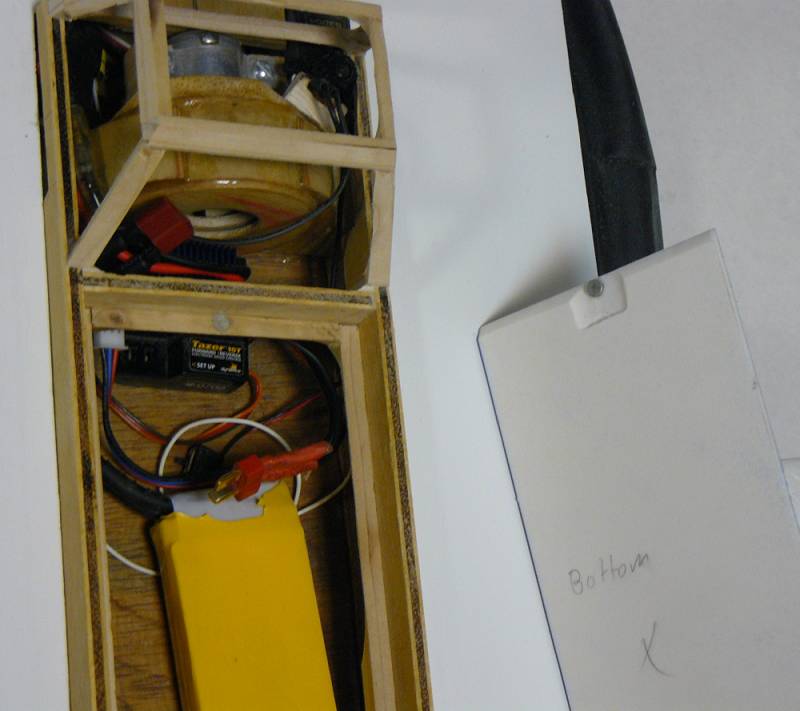

The hatch that he is glued to is held shut by a pair of strong magnets on one end and Ken's legs on the other. Right behind that I have started making the rear fan cover. This one is going to have every ounce of weight shaved off in order to help with the ballancing issues. As you can see, I have sanded off much of the pine supports and am now waiting to skin it and add vents. Other than that, I have to paint the center section and the outside of the forward thrust duct. Then there is the whole tripple rudder setup that has to be done... oh well... there is a Russian proverb that my mom always tells me, "eyes may be intimidated, while hands chip away" Time to start working! Expect another update soon.

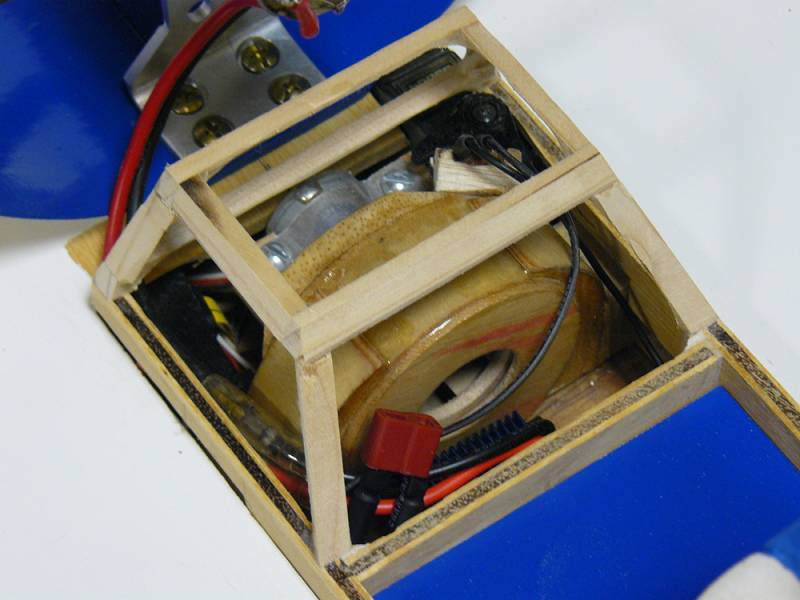

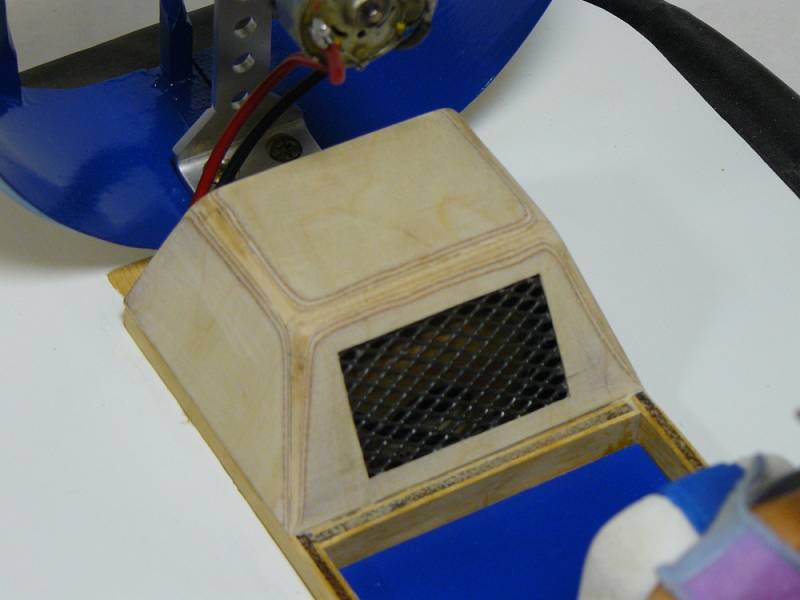

Meanwhile, I have not been sitting on my laurels, doing some painting. Instead of making the vents in the shape of slots in the rear cover I went with a mesh type covering. It is aluminum with a thin rubber coating. Now that I have painted the center section, I guess that there can be no more delaying of the inevitable... time to make those rudders that I have avoided.

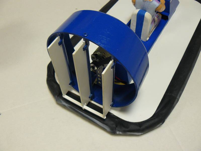

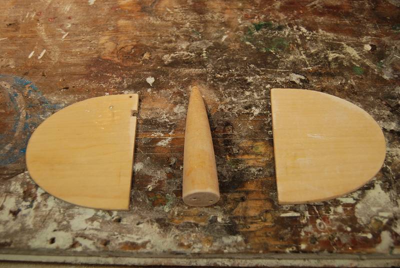

about the rudders... it's not about the actual cuts... I have two shorter rudders and a tall center one. For me, the problems usualy start when I make the hinges and connecting rods... I can never get those distances right...

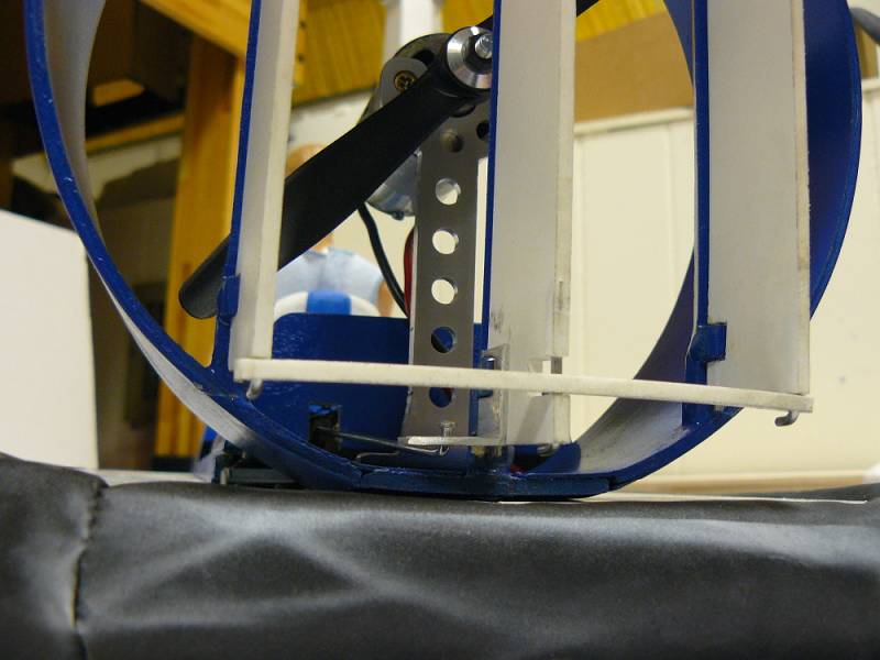

Do you have any antenna tube or pushrod tubing?
Works grate for making your own hinges with a bit of push rod or stiff wire
- Just cut to length then cut each end off
- fasten the ends to craft and attach the middle to rudder
- put wire or push rod down the tubes
- bend or secure the end so it won’t slide out
If you are worried about weight you could use foam rudders taped to the tube, it’s not vary durable but vary simple to fix and vary light.

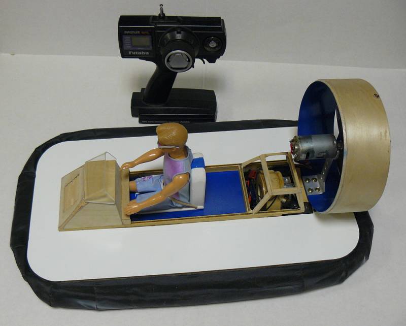

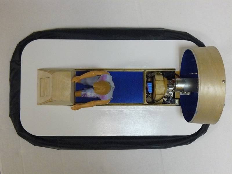

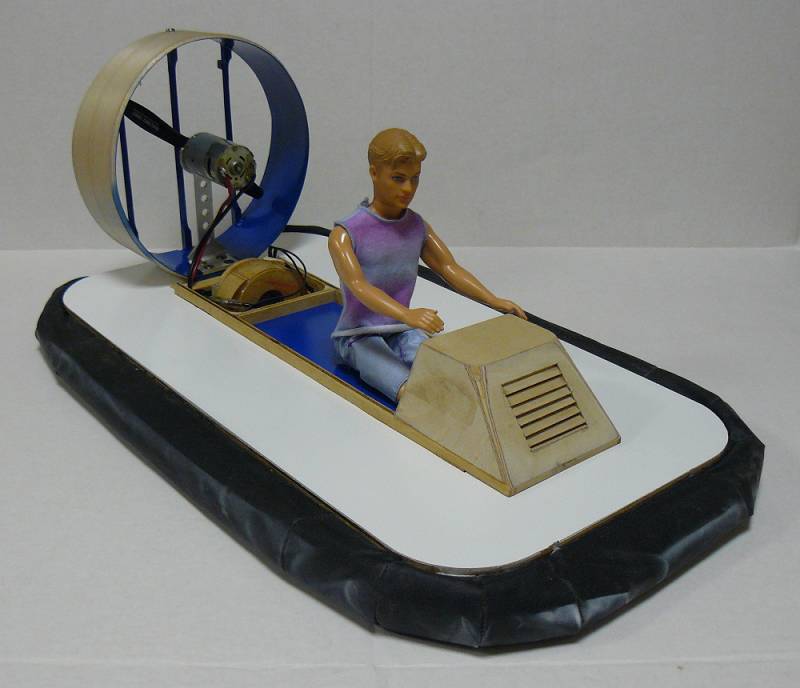

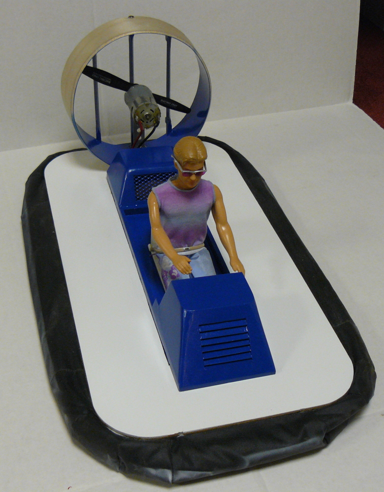

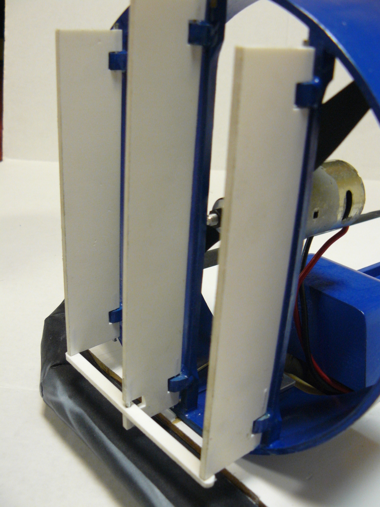

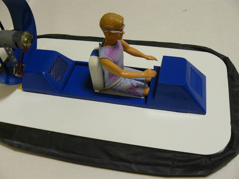

Well, this is the second time I am posting this... stinkin proxy server timed out!

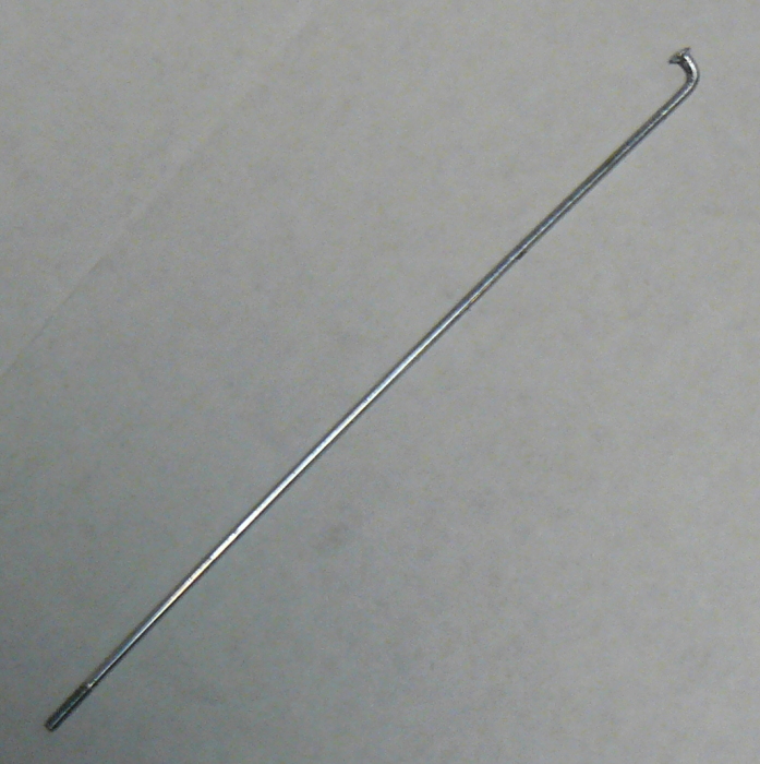

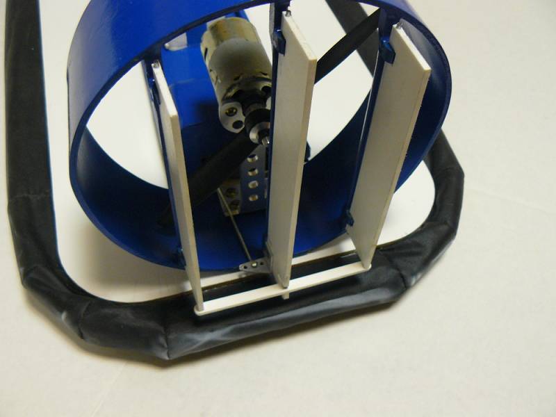

Attached are the pictures that I promised. The rudders are made out of 1/8" plastic (cut from a sign that my Dad brought from his work) and they are connected buy a pushrod out of the same material. These rudders are attached to the craft by hinges made out of 1/4" square pine blocks that are epoxied to the three supports that I installed previously. I used old aluminum bicycle spokes as they allready have threads on one end to hold everything together. I carefully drilled holes into the rudders and screwed the spokes in until theey were in all the way. Then I trimmed and bent them into an elbow so I would be eable to remove then if I ever needed to with ease. The rudder to servo linkage is also a spoke, however I used the other end, which is bent at a 90 degree angle that stops it from falling out of the arm. I make the arm out of aluminum angle, whith varying mounting holes if I ever needed more or less deflection. After that, it was time for testing.
It had been pouring outside all day so I was limited to indoor running. The speed was more than I needed in an enclosed space, so I think I may need to add a rubber bumper too keep the walls in my room intact. Every turn was a power slide until I pegged the throtle and countersteered, but soon I got the hang of it. This thing is so fun to drive once you get used to it. Now I need to stop messing around with it and get back to work. Ken still needs a way to control his hovercraft, and the OCD in me is pestering me about the section of deck that has still not been painted. Once it stops raining, I will go outside and take some video. So far, the top speed is about 10mph, but I am happy with it. This thing rocks! you guys don't know how satisfied/relieved I am that it works as I expected it to.
BTW, I have a name for her... Electric Slide! (its an electric and every turn is a slide
