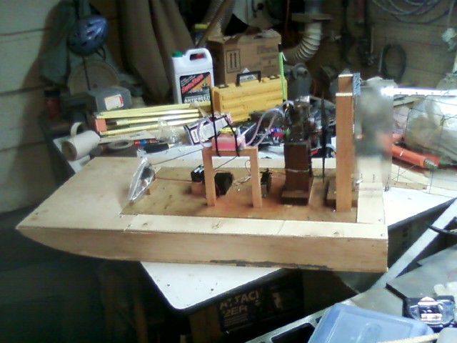

Ok, I just built an airboat. It snowed recently and I tried it out on it. It was the real wet and sticky snow too. I waxed the bottom of the boat, and the boat got up to about 15 mph in a 50 ft. flat stretch. Can anyone give me an estimate on how fast it can go on water?
I know there will be a lot of variables, but can anyone give me a guess?

More info on your boats specs and maybe some pics of the design would be helpful.

Sorry. It is 36 inches long, but 30 inches of it actually made contact with the snow. It is 18 inches wide and it sank about 1/4 of an inch down into the snow. It weighs about 10 pounds. I used a saito fa-50 engine with a 10X7 masterairscrew 3 bladed prop. I did have the engine tuned in properly too.

Sorry, here is a picture

seems to heavy to me for the size, at least for running well on the ground, I have a large gasser thats to heavy to run on the snow well...your boat interests me cause it has a four stroke on it and I just finished a scratch built air boat with a magnum .30 four stroke...mine sinks maybe a 1/16th of an inch in soft snow, not powder but very soft snow, I don't have room to run it out for long but I believe it would reach 40-50mph if it doesn't blow over. So that kind of performance may be something to shoot for in future hull...however your boat will definitely run better on water and while it may not be a powerhouse it should be super reliable and a ton of fun to just tool around the pond just like my large heavy gasser it...another good test for an air boat is if it will easily run on grass, even up grass hills...how bout some more pictures of the boat...
...p.s. I also fly planes and my plane that weighs 7-8 pounds uses a saito 91, and it just about has unlimited vertical, so thats another way around the weight issue, MORE POWER!!!...

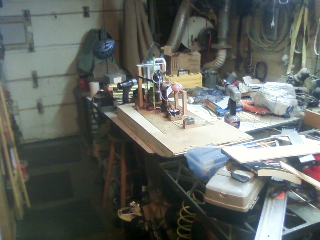

Here are some more pics.
P.S. I wasn't really going for looks.

side profile shape looks pretty good, so the only things that might cause issues are the rudders so close together and maybe in future builds angle the sides of the hull, not to much you can do about the weight since it's built so I'd say if it runs good enough on water that you enjoy it then leave it alone, if it's not fast enough for you strap a bigger mill on there to up your power to weight ratio...ran my .30 powered one today, on snow it was fast enough to blow over at about 3/4 throttle, thats a downside to light weight, they like to take flight...I'll post about the boat later once it drys off and I can take some pictures...

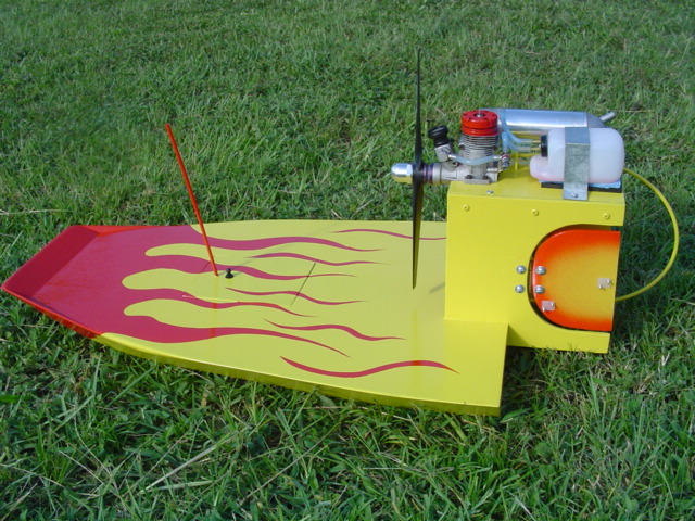

I GPS-ed my "Whats Hap'n" at 35.3 across the grass. Running a .46.
I got video of it somewhere. If I run across it, I'll share it.
