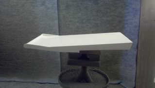

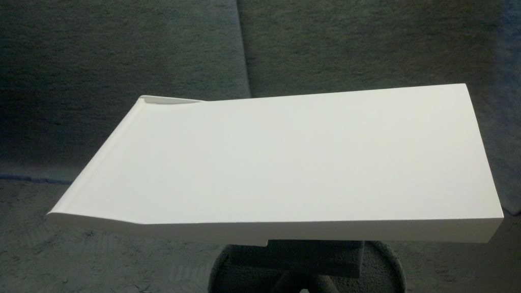

dadkins 04-13-2011 07:14 AM
RE: fast step hull
1 Attachment(s)
Here is MY fast step hull.

*delete M i k e u p delete* 04-14-2011 07:05 AM
RE: fast step hull
Eden Prairie picture #3 with airfoil. Now from my vantage point, the rakes front edge or the flat area needs to be changed. The air won't get near the foil to do its job.Tip or suggestion on foil; run a rod thru the support uprights for scoop and thread the rods end and wing nut it to make it adjustable. Man, it does look great and shows your workmanship and knowledge. Stain it and seal it and will look like a million bucks.
dadkins 04-14-2011 07:28 AM
RE: fast step hull
Mikeup,
Its hard to see from that angle - but when viewed straight on - about half the foil sticks up above the rake - I am probably going to gring the rake down another 1/2" too, in reality this is prbably 1 lb heavier than the previous hall and may not be as prone to flip so I am going to try it first - I may mount the wing on the top of the rake too ? we will have to see how it does without first - plus it's a little cleaner looking without.
