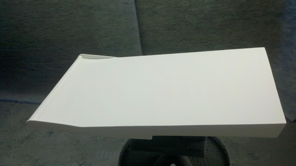

someone getting a fast bad step hull to run at the meet.
ID:	2237387Click image for larger version
ID:	2237388<br type="_moz" />

Now your making me think about adding a step to my new hull. I am currious if you have blowover problems if the step helps or hurts ? What do you think.

The addition of the step is beneficial to a hulls performance. At first you have 2 surfaces touching the water when on a mid to full plane and this eliminates the porpoise effect that comes along with having only one surface in the water trying to balance out the weight of the boat. Second the step allows for a controlled hydroplane effect and this happens when air is allowed to flow under the hull and leaves as compressed air under the transom hence actually making less drag and with this in mind the actual boat weight vs. the surface weight friction is reduced. If you were to take a flat bottom hull and a step hull &ldquo;same length&rdquo; and rig them out with the same motors and with the hp the same and have the same propellers and the same weight riggings the step hull will travel further on fuel, faster at top end, and will ride flatter. On the other hand the operator must adjust to the way that a step hull is operated in driving as compared to a flat bottom. A flat bottom will dig in a turn as where a step hull will slide. I have seen where full size boats must start turning before the actual turn and power out of the slide. But the last statement was from my own personal experience.</p>

BBG. Good to know - what about land performance ? seems a bigger flatter (flat bottom) surface might slide a little easier.
Snow - should be about the same - I am seriously thinking of steping my hull.
Are the front and back sections at the same plane - with just the step cut out ? or are they at slightly different levels ?
I am also planning on putting air ducts coming thru the rake to relieve air pressure and reduce blowover

little slick bottom and they run the hill fine. And yes the two step are on the same plane. Like BBG said stephulls are great running fast boats. I have built like 20 something flat bottom hulls and never got one to run like anywhere close to the way my step hulls run. U can run them almost wide open the whole time if u have enough room to slide them  around. After i built the first step hull that i put  a .46ax on i loved the way it ran in water. But  it wouldn't run the hill. Added slick bottom and it ran the hill fine. So after that the flat bottom boats where dead to me. step boats will bounce on dry ground a little . but on snow it should run like its on water. Although  I never ran one on snow. Dont have any here
