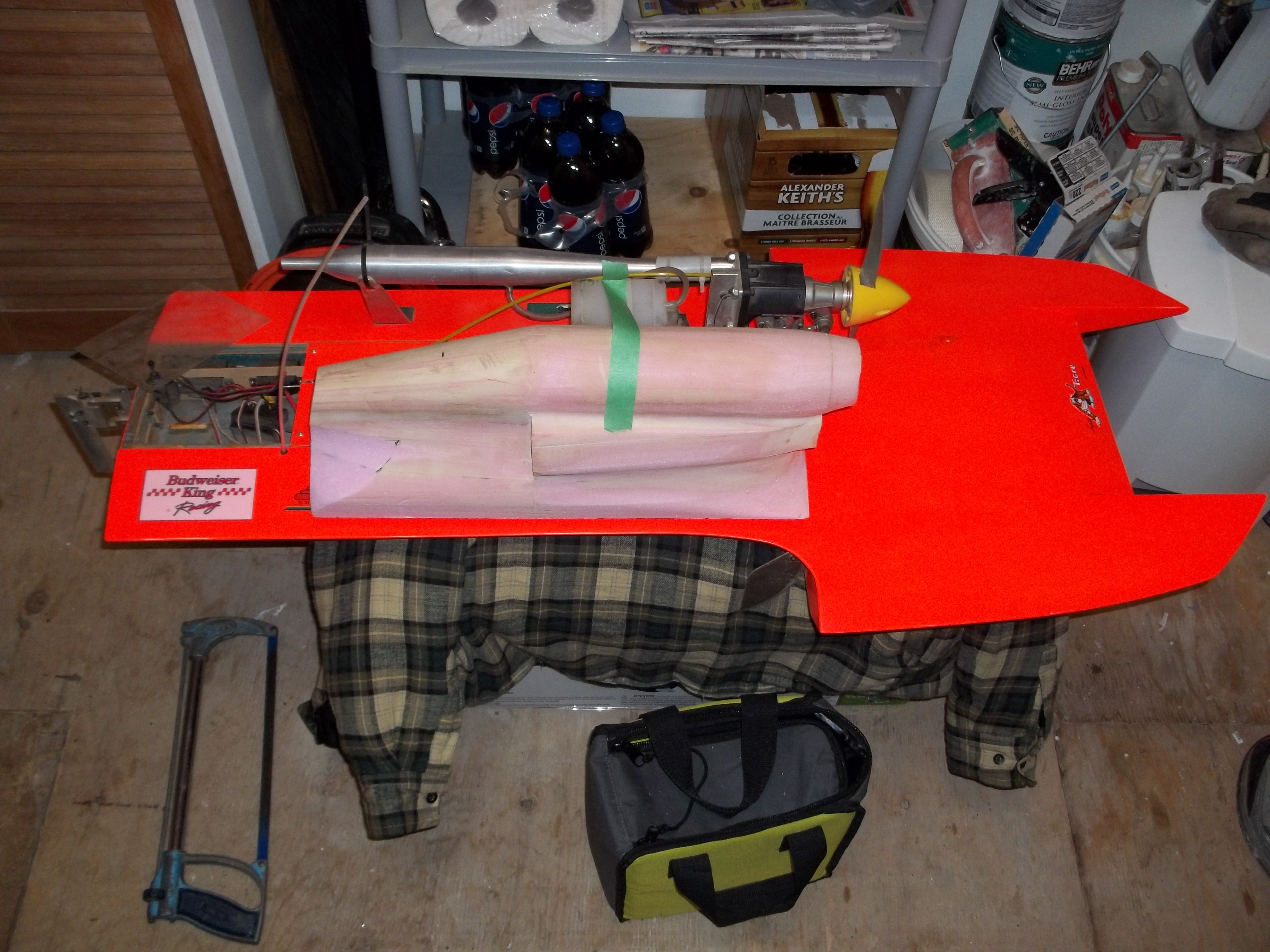

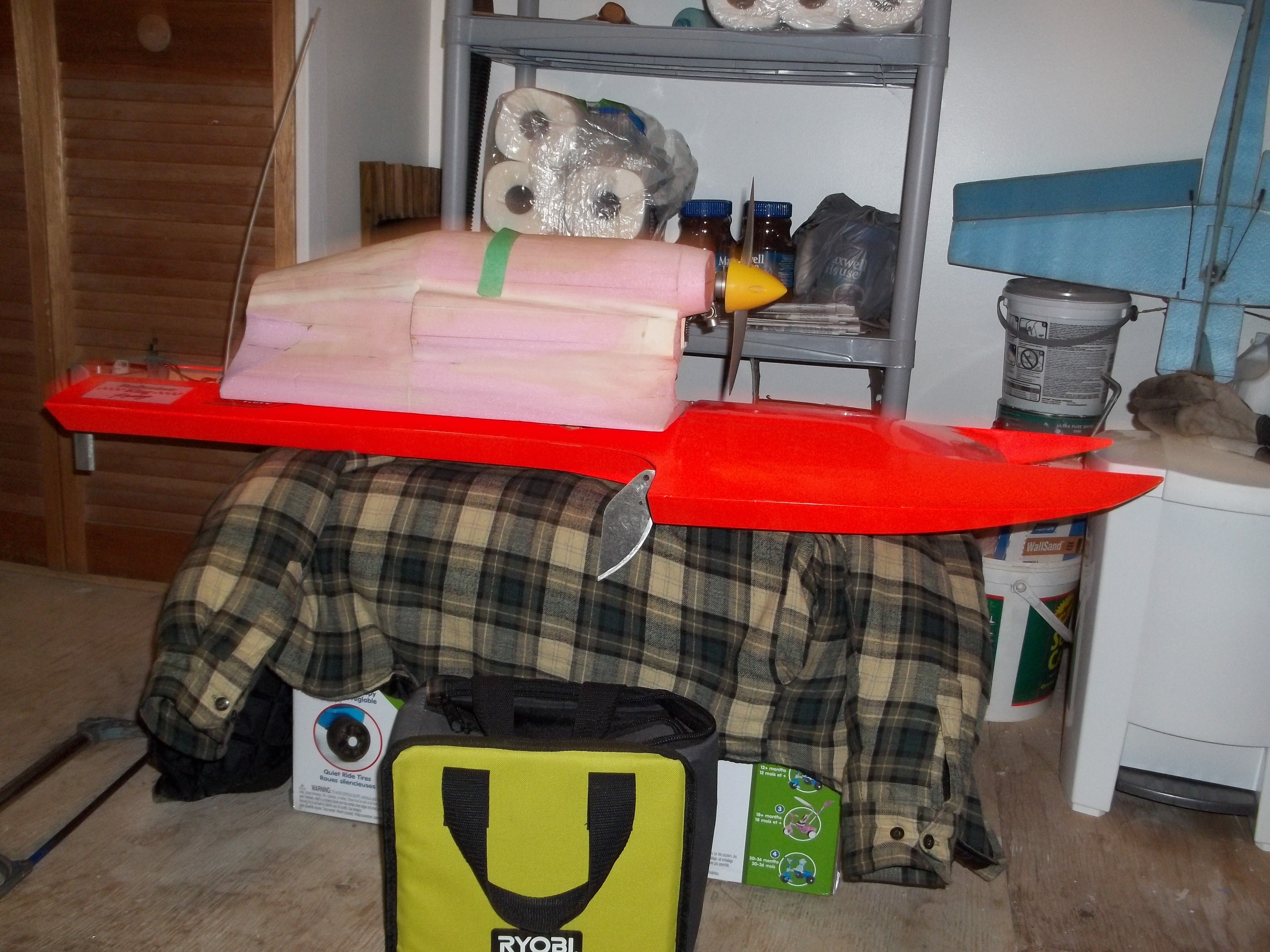

2 Attachment(s)
Here is a couple pic's of my own creation, the boat weigh's about 4.5 lbs and as you can see from the pic's I'm trying to create some form of body. Initially in the construction and experimentation of the hull I had to redesign the riding surface of the front sponsons due to a strange duck walking effect, after changing the ride surface angle it went without a hitch as mentioned earlier. I found that the 2 degree up thrust angle of the engine was just enough to lift the hull and still maintain adhesion to the water surface all in all a great successful experiment. Anyone else have a contribution?
http://www.rcuniverse.com/forum/atta...mentid=1958322http://www.rcuniverse.com/forum/atta...mentid=1958323

1QwkSport2.5r That is an interesting rigger you have is that an original or an adjusted plan of some sort? may I ask what is wrong with the sponsons? I followed your build on the SI3, quite interesting and I also watched the vid that thing moves, how's the turning at speed? Here is a thought if the motor was inverted and the hull modified to have a 1" deep divot for lack of better terms the CG would be lowered considerably. I wouldn't be one bit surprised that the outrigger will do in excess of 60 without too much difficulty. Thanks Jeremy_H unfortunately I have promised that hydro to my son and it has been downgraded to a TT 46 so it'll be a little more fun for the beginner, too much speed for the new person can be a dangerous thing for all concerned. I do have several motors including a couple 90 4 strokes without a home so a new build in the future is a great possibility once an idea pops into the old grey matter! Has anyone used 4 strokes and power response is there a great deal of difference in response? I have the motors for a couple of planes that I have lost interest in and likely going to part with them, I guess I could always sell the 4 strokes and get a 2 stroke of whatever size needed. Another option that has occurred to me is has anyone tried a PTO and placed the engine down in the bottom of the hull?

The sponsons on my rigger aren't quite big enough and the profile is wrong. It wants to submarine instead of plane out. More show than go as built.

1QwkSport2.5r In regards to the sponsons not getting on plane would possibly adjusting the engine a couple of degrees up not assist in getting on plane? Could the back end be too light? As I mentioned earlier the issue I had with the hydro doing a strange porpoising type walk I adjusted the ride planes on the sponsons to about one degree by sanding down the surface and adding an additional layer of lite ply and adjusting the engine up about 2 degrees up, just a thought. I had also considered curved turn fins on the sponsons to aide in turning and to prevent roll overs.

I tried adding almost 10* of upward thrust angle to the engine mount (prop) and it got no better. The hull sits low enough in the water that the book tubes are in the water and the surface tension is too great to overcome which then makes it submarine. Me and a buddy tried for a couple hours trying to get it up on top and no such luck was the case. There is nothing else that can be done with it as-is; it just needs new sponsons.

I do have a couple of questions if you would be so kind, there seems to be quite a debate on the sponson angle, I respect the experience of others however the sponsons on my hydro are only 1 degree (side to side) angle at the rear and gradually increase toward the front at an approx up angle of 2 degrees from the back and increasing as it goes forward, that boat has done over 70 mph. If you would like some close up pics of the ride surface I'd be most happy to oblige. You state a fellow by the name Hooty301 has built a similar rig? what are his sponson dimensions, similar to yours? I am considering a rigger build myself once I have done the research and am considering a ply over foam method, could be interesting!!!
1QwkSport2.5r 01-23-2014 06:17 PM
I freehand drew my sponson angles, no idea what my angles are. There are no dimensions of Hooty's hull other than the length is about 4 feet. Overall width is in the 20-24" range. Beyond that I don't know. Here is his rigger thread: http://www.rcairboats.net/phpBB/view...php?f=50&t=314
I will say I'm making new drawings for the sponson rebuild and I will be using a very similar rake angle as my SI3 boats. A very smooth curve with no flat spots and sharp corners.
